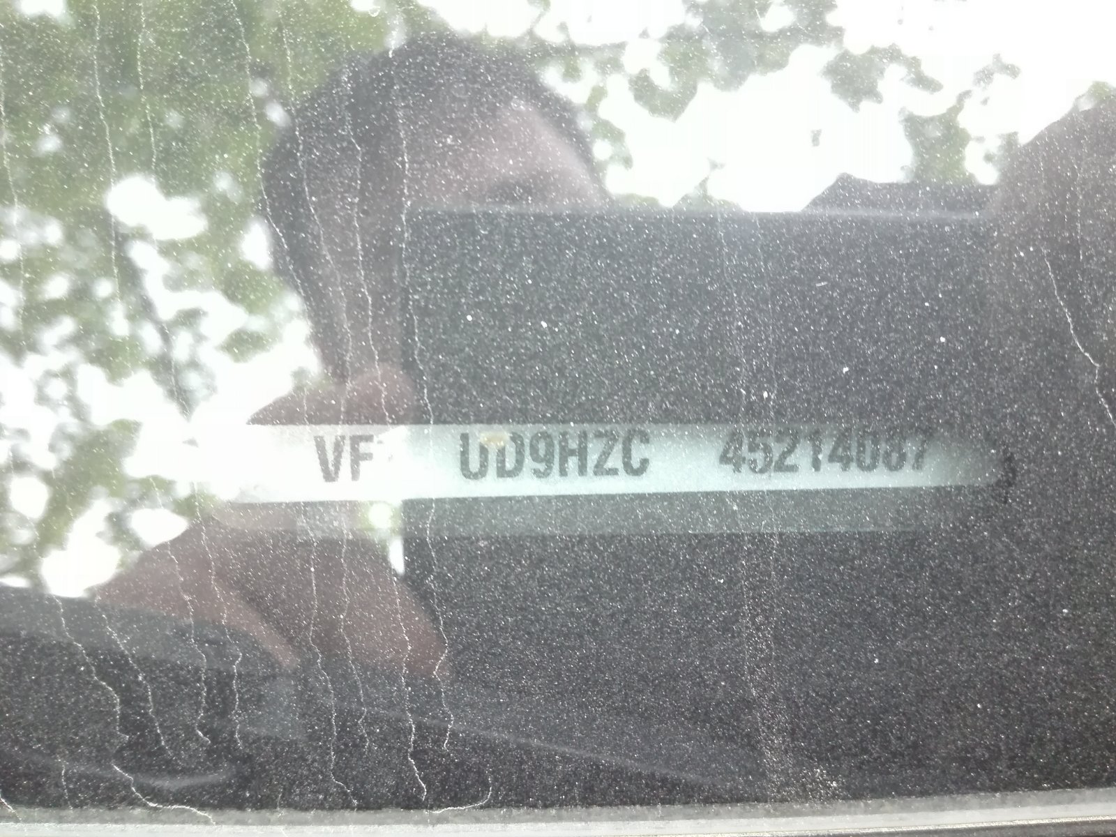

Re: Magneti Marelli rt 4 problem
What I'm saying is the screens are not the same in the pictures. You can rarely mix and match these units.
What is your VIN? I can see what the screen code is for your system.
Here you go.
Ok, so here is your problem - Citroen only sell the complete instrument panel (over £3100!!!), so very expensive. they don't show the separate screen, so I can't get a code for that.
I would forget about the screen completely and just get an RT4 that is THE SAME as the one in your Picasso, like this:
https://www.ebay.co.uk/itm/RT4-radio-na ... Sw1utaz8M0
The earlier units are quite hard to get hold of as you have found out, which keeps the price high.
I simply cannot say whether the C6 unit is compatible with the C4 Picasso for sure - because of the different vehicle architecture, screen etc. and a bit of a risk to take.
