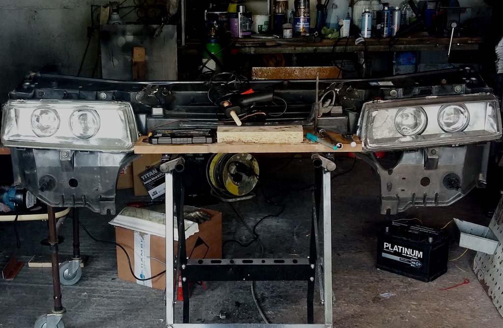

Lighting test Rig
- Posts: 55127
- x 8411
Re: I am an Activa owner...a V6 and I am an addict (and now I have an AX and ZX as well)
Car removed for clarity...
Alasdair, what's the legality of these lights given the MoT regulations concerning after-market HID conversions?
I'd think that as the light units themselves are properly designed for HIDs and the car has self-levelling suspension then all should be OK...
Looking good though
Looking good though

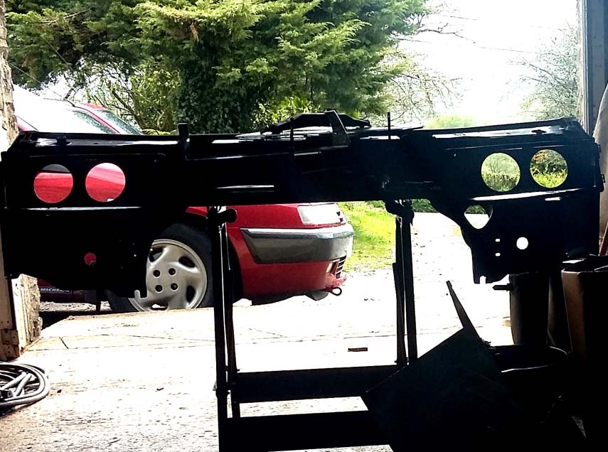

These lamp units are not HID Jim, they are "modular" halogen units using standard 55w H7 bulbs, the lamp modules are from Hella and carry all the required standards. Regarding the "modified mounting" I have not got a clue, I will wing that bit as the MOT makes no comment on it.

Which Hella units were they, Alasdair?
Being H7 (single filament), how was a dipped beam achieved?
OnlineStickyfinger
- Posts: 11837
- Joined: 28 Mar 2013, 21:05
- x 1994
I have two Dip and two Main units. (inner=main / outer= dip)
Any 90mm unit should fit so it will be a personal choice if LED or other 90mm units are used, there are lots to choose from.
