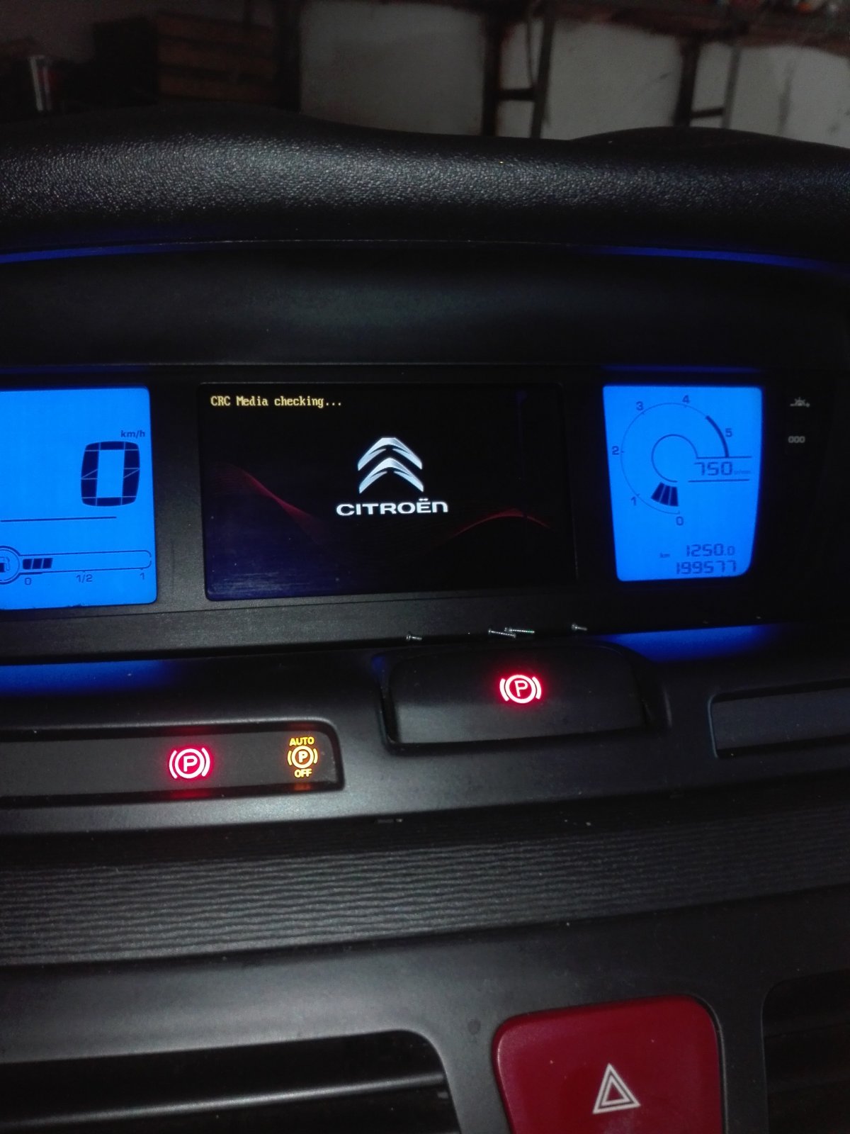

Hi guys.My name is Boyan and i'm from Bulgaria.Nice forum .I want help for my device.have a big trouble.The device go to reatart.I see only logo on the screen and then restart.I held up the 2 small white buttons for reset system.,then screen ask for upgrade cd
I put on the sw 8.31 but the system writes crc media .checking and do nothing
After some minutes device crashed.i don know what to do.I try change hdd with other 30gb p ata hdd and make image of the old hdd but no change
Help me what to do.Or the device is dead and i search second hand other rt 4.pls help me.
Thanks.excuse me for my bad english

Hi and welcome.
I suspect that you need to burn the firmware CD again - but use a different CD-R and burn it at not more than 4X speed. The CRC means there are problems with the data file and it cannot read it most likely.
When you have done hat and finalised the disk, do the same thing by restarting it with the 2 white buttons held in as you have done.
See how you get on with that.

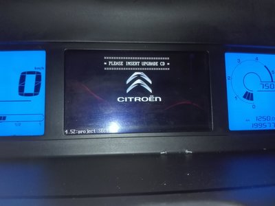

One year i no have trouble.a few days i loose any sound.after that the system go to restart.when i put on the white buttons device ask for upgrade cd.i put on same cd who i use before one year.but sytem screen wrire crc media check and crashed.i doubt the mainboard is dead.
I successfully update ro ver 8.31

When i put the white button the device reset and go to please upgrade cd .i put cd and tha same again and again.crc media checking ..

Today i try this but nothing.i put the cd in.when device start the cd rom turn around and stop spin.write insert cd upgrade but not spin to read the disk.cd with 8.31 is in.

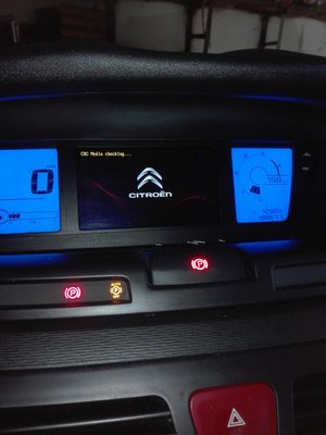

Ok i understand.but what those mean crc media checking.where check?hdd,flash ,cd rom,mainboard.Every time when i press white buttons the system restart and try to boot .but stop on this checking.

CRC is cyclic redundancy check. It's basically checking the installation media for errors before writing it to the hard drive to ensure it's not writing a corrupted firmware.
