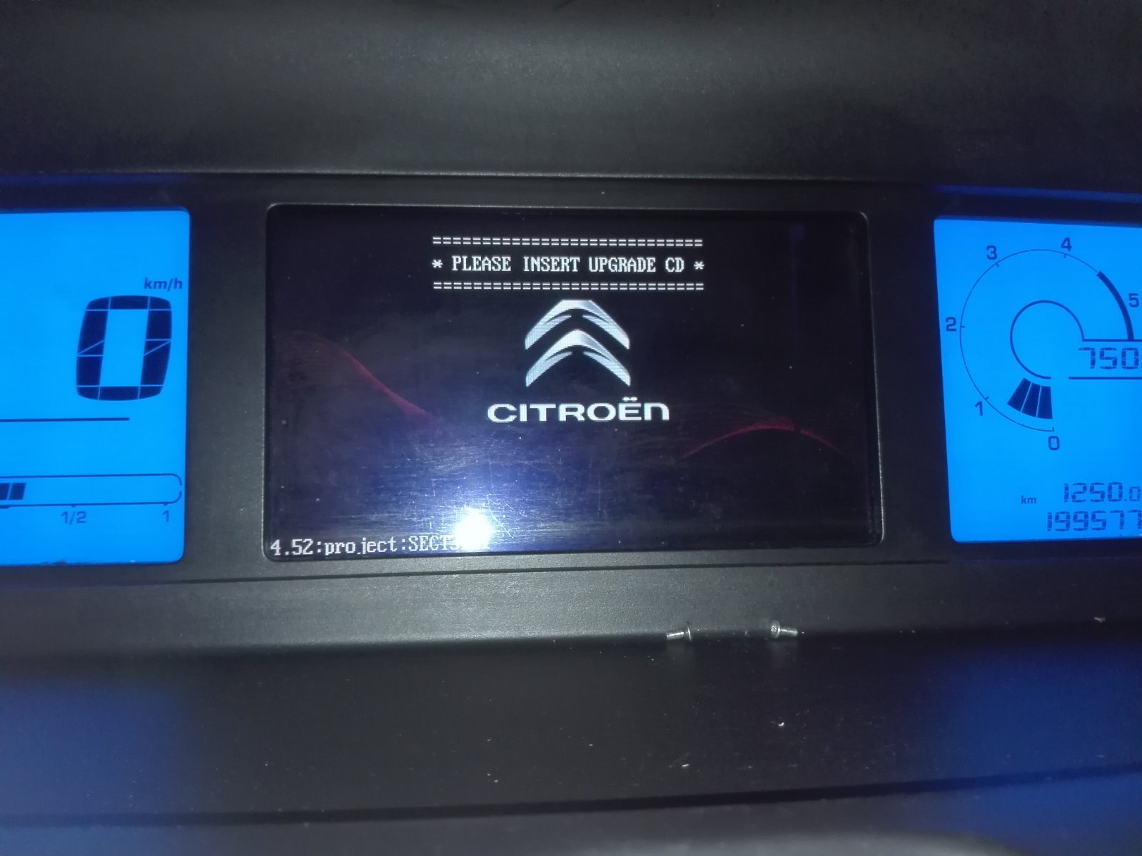

Hi guys.My name is Boyan and i'm from Bulgaria.Nice forum .I want help for my device.have a big trouble.The device go to reatart.I see only logo on the screen and then restart.I held up the 2 small white buttons for reset system.,then screen ask for upgrade cd
I put on the sw 8.31 but the system writes crc media .checking and do nothing
After some minutes device crashed.i don know what to do.I try change hdd with other 30gb p ata hdd and make image of the old hdd but no change
Help me what to do.Or the device is dead and i search second hand other rt 4.pls help me.
Thanks.excuse me for my bad english

When i put the white button the device reset and go to please upgrade cd .i put cd and tha same again and again.crc media checking ..

Today i try this but nothing.i put the cd in.when device start the cd rom turn around and stop spin.write insert cd upgrade but not spin to read the disk.cd with 8.31 is in.
