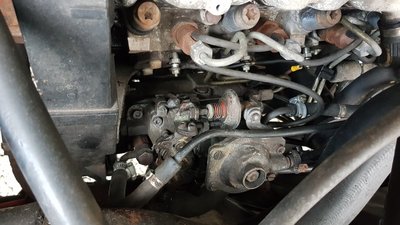

Here's the pump, Bosch?

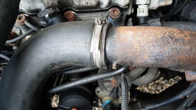

This looks suspect?

Yeah, that looks like the Bosch pump to me. It's difficult to tell from the second picture to be honest if anything is amiss.
Were you down on power at all or could you hear a hissing noise like air escaping? This engine has the top mounted intercooler, is it making a good seal with the inlet manifold?
