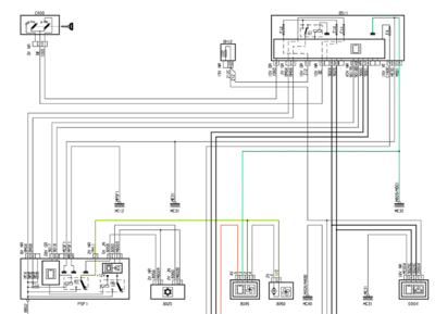

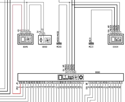

Here's the relevant bit in 2 parts - you'll need to click to zoom these. The red line goes to the Climate Control ECU on the dash in the second half. I've added relevant component codes in the table below.
With this particular system, there are no wiring codes, just numbers. So the power is delivered from the engine fuse box to the blower motor control module and then on to the motor itself. I think it would just be simpler to replace - not too bad as it is near the pollen filter. You can see a picture of the vicinity from my pollen filter change post with pics:

| Code | Description |
| 8045 | Blower Control Module (if separate) |
| 8050 | Blower Motor (If Separate) |
| 8080 | Air Conditioning ECU |
| PSF1 | Engine Compartment Fusebox Panel |
| MC32 | MC32 Earth |
| BSI1 | BSI |
