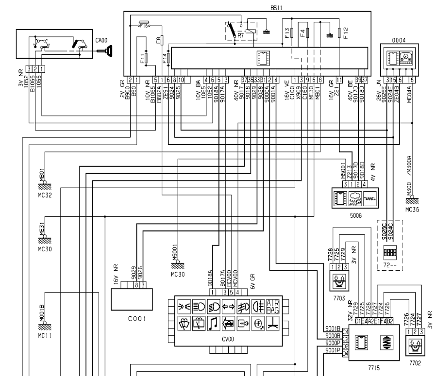

Does anyone have the wiring diagram for the xenons and washer jets please for 2006 / 07 C5 Xenons? Want to retrofit some to mine

Here you go, unfortunately, the wiring codes are a bit nondescript. I've overlapped the second half for continuity. I've assumed you've got ESP on your vehicle - as it will need the steering wheel angle sensor for the directional function to work.
Click to zoom these

Thank you marc! Looking to retrofit some directional xenons to mine , will investigate what (if any) of teh wiring is in situ already

No problem, don’t forget you’ll need the Headlight Auto Adjustment unit too. Number 1 in the diagram. The headlamp corrector (5) should already be incorporated into the headlight unit.

I’ve recently looked into this, fitted some xenon headlamps into the car, the loom powered the xenons (which only do dip beam, they are not bi-xenon), and main beam etc all corectly.
The loom for the directional portion is not there, or at least it isn’t on my VTX+
So you will never be able to get them fully functional without a new loom I’m afraid. Half the wiring is missing on the ‘lesser’ spec loom.
x 6957
Re: Wiring diagram for xenons - 2007 mk1 facelift C5
Did you fit different xenons then I.e. non Citroen ones? The Proper Citroen bi-xenon for the C5 MKII works in main and dipped beam modes as well as having a second main beam standard headlamp to compliment them. So I’m guessing you have fitted some aftermarket ones then?

Mark I facelift or more commonly referred to as MK II (late 2004 - 2007). Yes they are bi-directional, having motors incorporated into the headlamp for levelling and directional functions. But if you don’t have the necessary kit / wiring needed for the directional functions, they will remain static in backup mode as if you had turned the directional function off.
