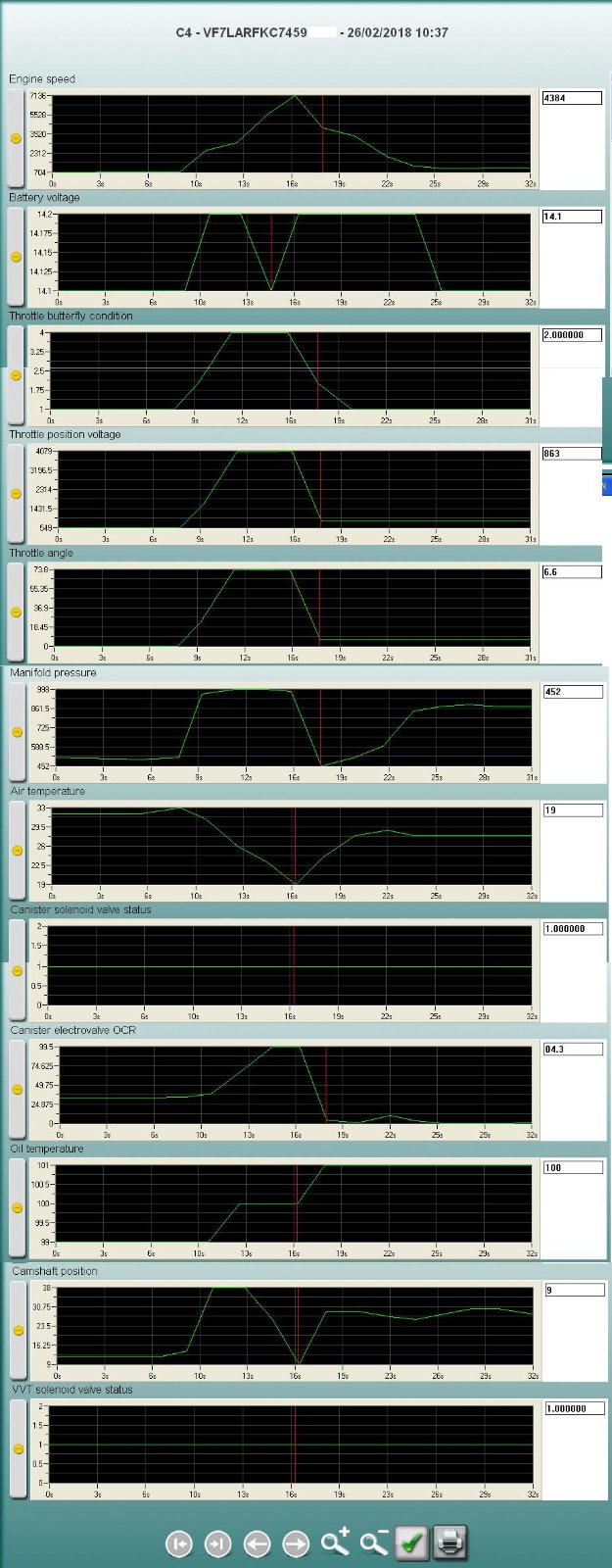

I have done some more runs and edited screen prints for one of them together to give the complete list
I also enlisted SWMBO to video the laptop screen as I drove so both of those are here
My observations (even though I don't really know what I'm looking at or what to look for) You can see that the engine speed peeks at just past 16 secs whereas throttle position and butterfly angle both drop off just before 16 secs.Could this point to the pedal being faulty?
The camshaft angle goes up to 38 degrees as the revs rise and then drops suddenly at about 13 secs. The strange thing here is that the graph for the VVT solenoid if a straight line, should this be the case? The video of the live data shows it as "active" and when I did an actuator test on it last time there were no faults reported for it. You may remember that it is a new solenoid as well.

Did that run provoke the limp mode? I can't see what's happening in the video really.... You want to try and see if you can see the pedal position and the butterfly position in the live data, and to see if they have copy position signals, and how these look against the input position. You don't need to drive it to look at these - and you may well not even need it running!

RichardW wrote: 26 Feb 2018, 22:31 Did that run provoke the limp mode? I can't see what's happening in the video really.... You want to try and see if you can see the pedal position and the butterfly position in the live data, and to see if they have copy position signals, and how these look against the input position. You don't need to drive it to look at these - and you may well not even need it running!

Yes it went into limp on each run I did, in this case at 7136rpm. As I understand it the red line (when the rev counter lights up red) should be 7200rpm and the rev limit 7400rpm and it never quite gets to either of them.
I don't really understand what you mean by copy position signals, but on the graphs the pedal and the butterfly closely follow each other until the engine dies.

There should be 2 signals on the throttle body - one is the requested position the other is the reported position (ie the copy signal) if the two don't agree then it flags a fault - I think this is the P1160 / 1161 fault you are getting? What fault was it reporting when it went into limp the other day? Hopefully in the live data you can see both the requested and the reported position - and they should track one another. When I had trouble with the EGR valve on our C4 I eventually tracked it down this way - the reported position was all over the place. On the throttle pedal it may well have 2 tracks which should read the same - again if they don't it will spit the dummy.
