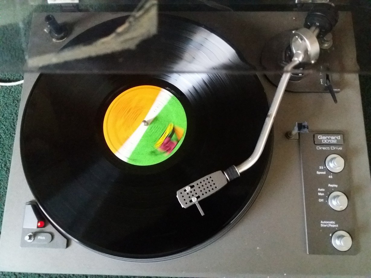

I was wondering if he, or anyone else 'in the know' with this sort of thing, could point me in the right direction regarding an old Turntable.
Its been ferreted out of the loft after at least 10years up there, in the course of clearing out. On testing, there's no sound.

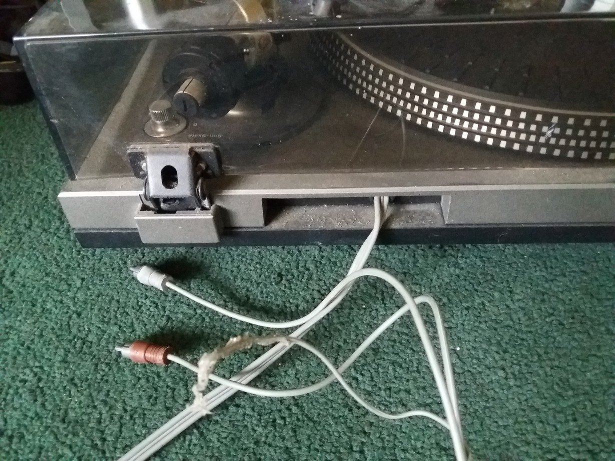

I tried both connecting it up via RCA to my 1990's Midi/Amp*, and also tried connecting it directly to a 240v Hi-Fi speaker (of same Midi). Its controls do not include a volume function so its clearly meant to be teamed with an Amp.
There's a little sound 'leakage' (?) just audible close to the Stylus, but nothing through the wire; the connections there are all good. The wire itself is a bit weird, its got a pair of RCA's, simple enough, I did clean 'em up with wire wool, and a third wire in the middle of the three, looks a bit like a Radio Aerial wire, but can't be as the Unit is only a Turntable.
It appears to be a nice quality unit, the Missus remembers using it at her previous home (before I knew her) and its highly unlikely it was 'non-working' when put away.
If it can be made to work its going to be sold, if not if anyone wants to lay claim to it, Jim?, I'll make a note to drop it by next time I'm up that way.
I've not had it apart as yet. Other than the lack of sound, it spins up and the functions & arm all work just fine.
*Sony HST-D501
That's Boney M on the Turntable by the way.... strewth!

The third wire is an earth wire, should be connected to an earth point on the amplifier. Prevents mains hum (feedback loop).
You may need a phono preamp or an amplifier with a phono input for it depending on the cartridge - as it is a Dual this is almost certainly the case.

Yes - will need a "phono pre-amp" to lift the 3mV cartridge output to the 100-400mV level required by Aux/Line input. Also applies the correct RIAA equalisation for the signal.
Alternatively, use an amplifier with a Phono input, where the pre-amp will be built in. Bit rare these days.

You may hear it very faintly but if if it has a magnetic cartridge the output is so low you are unlikely to hear much at all on anything but an amp designed for magnetic cartridge inputs and as said earlier, they're rare now... Guitar amps are a little more sensitive than a modern stereo amp but not nearly enough to handle a magnetic cartridge plus the response curve is all wrong...Pug_XUD_KeenAmateur wrote: 14 Mar 2018, 14:26 I've found a twin RCA to 3/8 converter and a Phono Jack, so I'm going to plug it into daughter's 1970's (approx) Guitar Amp, see if I get any 'joy'
Records are mastered in such a way as to tailor the frequency response in such a way as to limit groove excursions and to limit noise - especially rumble from the turntable. This is called pre-emphasis and is standardised by the RIAA. On playback the signal from the cartridge is passed through a de-emphasis network to restore the correct frequency response... If you listen to a record without RIAA equalisation it sounds awful - very 'toppy' (thin) and lacking in bass...
As a side note, this is the basis of Dolby noise reduction on tape decks but in the opposite way... FM radio uses pre and de-emphasis too. Both tape and radio is to limit high frequency noise - something tape suffers from badly and radio too when the signal is a bit weak...
If you hear nothing at all from your deck then assume the cartridge is duff - good ones are now expensive and high output ceramic cartridges that will drive a modern amp ( and don't need RIAA equalisation) hail from China, tend to be a disappointment and may not even fit your deck...
What you hear when you place your ear very close to the deck whilst playing a record is not electrical at all but acoustic (mechanical)...
