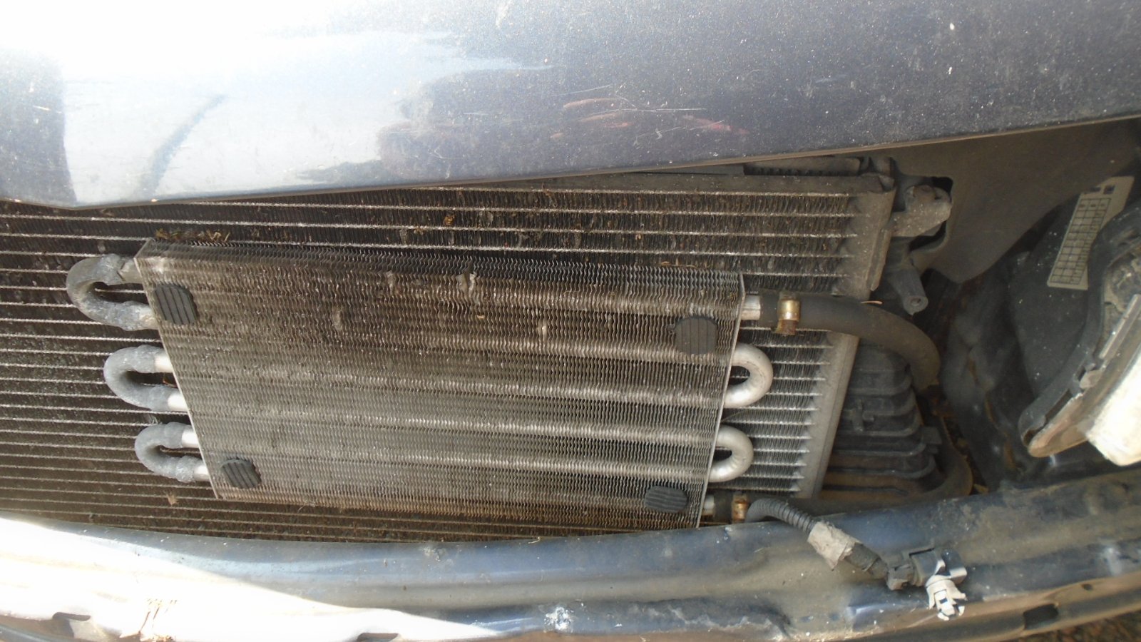

- Posts: 26401
- x 7162
Re: Aisin TF-80 / AM6 oil, cooler and filter modification project.
I've currently got the front off the vectra so here's a picture of my cooler fitted to my vectra. Simple air-cooled "radiator".
Has sat infront of the intercooler for the last 140,000 miles, no problems, and the box (known as an Aisin AF40-6 in GM circles but is the same Aisin TF-80SC also known as (AWF21, AM6, AW6A-EL)) is still working well at 200,000 miles (rebuilt at 60,000).
