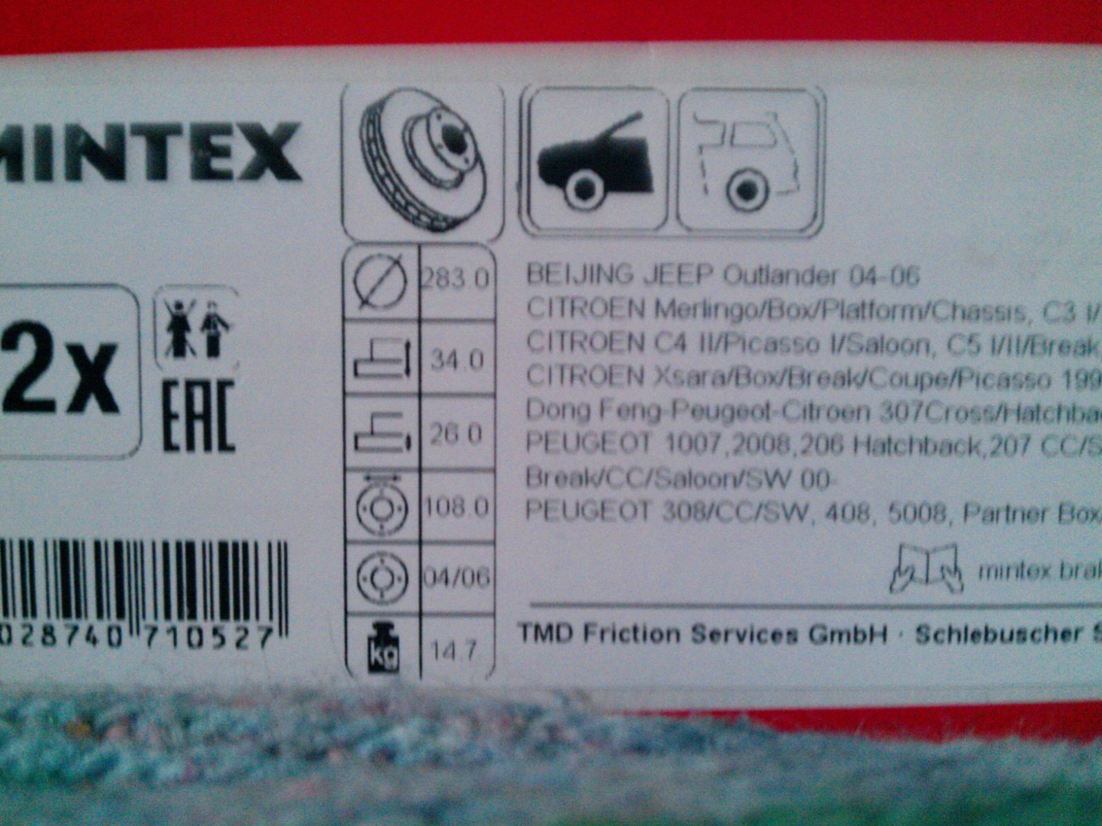

lexi wrote: 05 Mar 2018, 22:14 These are the deals you look for Mike.........if they are boxed Mintex should be OK.
Poor little twig of an immigrant guy just delivered my hefty package. "It's very heavy" he informed me as he passed them over.
They are boxed Mintex and even come with a hologram seal so hopefully they're not fake.
Though there is a schoolboy typo that I wouldn't expect from a German manufacturer....

Merlingo! Are you sure these aren't knock offs!!
MikeT
- Posts: 4808
- Joined: 11 Jun 2007, 16:17
- x 232
Re: MikeT's C5r 1.6 hdi Estate
Stop it, I was 99.9% sure.
First off, the seller has 10's thousands of 100% feedback
The price is good, but not too good to be true
The box looks real (apparently fakes have colour/font/logo differences)
The included instruction leaflet looks top quality (fakes usually skimp/fail here)
Mintex (TMD) claim their security holographic seals (which mine has and was intact) are 100% proof it's a genuine product
