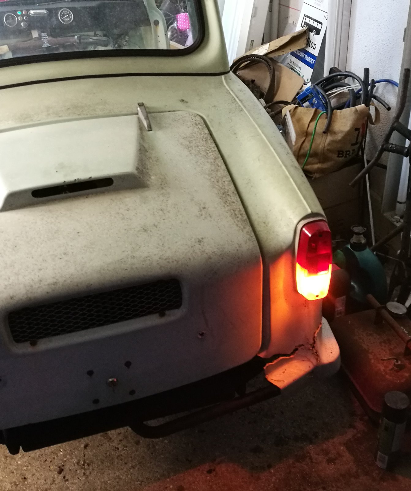

Well that was painless!
Couple of hours spent sitting out in the lovely sunshine this afternoon tidying up some of the engine bay wiring and reconnecting the tail lights properly. One thing I did change was to do the earthing locally. Originally they were grounded through a wire in the loom which went all the way back to the front bulkhead ground point. I decided that was daft, so grounded both ends of that wire, and stuck a ground connection to each cluster to a bolt under the ignition coil bracket on the near side, and the voltage regulator bracket on the offside.
Sure enough, look at that...we have fully functioning tail lights.
(Note that there's no hazard flasher functionality - I may well add that via a "bolt on" unit as it seems a useful feature to have).
I was expecting a bit of a battle to get all three bits working at once, but nope...Brake, tail and indicators all operate correctly without having any effect on each other.
They are currently missing their gaskets, so I'll need to come back to that at some point in the future, but it'll do for now.
Glad to report that the dashboard indicator is also behaving itself. You've no excuse for forgetting to turn the indicators off in this thing as it's by far the brightest light on the dash - I had to use the flash to get this photo without it totally washing out. Amber is the one for the indicators, again like quite a few other cars from this era (and still quite common on motorcycles I believe).
Sadly the fuel gauge is totally open circuit, so will need to pick up a new one to replace that at some point.

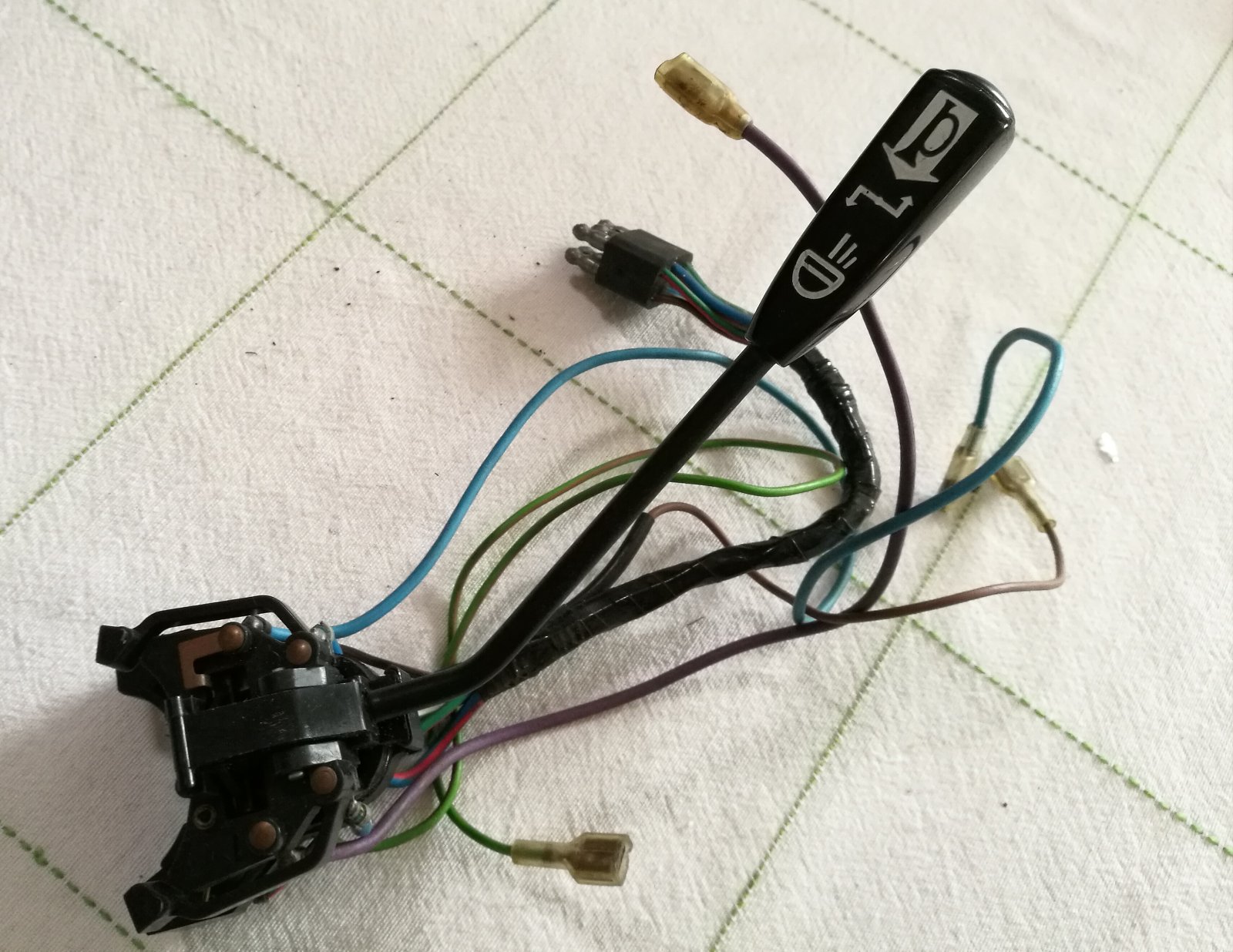

Time is going to be short today, but this just arrived in the post.
Hopefully that will restore reliable operation of the indicators and headlights (without needing to use a pair of pliers to change direction!). Has a different connector (Land Rover specific I believe) but is otherwise identical, and is easily sorted with some crimp terminals. Will report back later.

The only difference (aside from the connector - which may well have been on the original one when it left the factory for all I know) I could see on the new stalk was that the new one has a purple wire that doesn't exist on the original. I've just terminated it and left it alone for now - guessing it might be a feed for a dim/dip device or something like that as it looks like it leads into the contacts that handle the headlight switching.
Pretty quick and painless job to get it wired in and the cover back in place.
...Though we did initially have a bit of a head scratcher, in that turning the indicators on resulted in all four flashing (and the flasher unit sounding distinctly unhappy about this). Took a bit of head scratching, but it turned out to be that the screws I'd used to fasten it to the column were too long and were bridging the contacts for the left/right selection. Switching them out for some that were slightly shorter resolved that issue and got things working as they should.
The offside ones still flash slightly faster than the nearside ones for some reason, will sort that out later. My money's on dodgy tail light earths until proven otherwise.
Funny how adding something like this does so much to make the dash look more complete.
I've not wrapped the wiring for this again yet, as I think I want to make it a bit longer as it currently pulls more on the loom at full right hand lock than I'd like. That's a job for another day when it's warmer though and I've more time.
In other news, the fuel gauge has revived itself! Noticed today that it was "twitching" when I turned the ignition off - and sure enough, it now responds as it should do to varying the impedance between the connections for it. Guess I'll pull it out of the dash for a clean then if it's going to work.

Just a quick thought on the superfluous wire, could it be an extra/alternative feed for the dipped beam to work with quad lamps where the dipped stays on when main beam is in use?
'96 ZX SX 1.9TD, White, 88k
'12 Mini freebie project
Zelandeth
- Posts: 5303
- Joined: 16 Nov 2014, 23:36
- x 1593
Re: Zel's Fleet Blog - Xantia Activa, Saab 900, Lada Riva, Sinclair C5 & New Arrival AC Model 70...
ekjdm14 wrote: 26 Feb 2018, 19:23 Just a quick thought on the superfluous wire, could it be an extra/alternative feed for the dipped beam to work with quad lamps where the dipped stays on when main beam is in use?
Not a bad thought. It's definitely intended for something reasonably heavy as it's a thick wire. Would have expected it to be blue really if it was though based on the general wiring scheme where everything headlight related is blue (from memory, solid blue is dip, blue with a white trace is main beam and blue with a red trace is side/tail).
Granted I've not actually looked up the official legend for the colour code yet...really should do.

The standard (British) colour coding is:-
blue: head lights
blue/red: dip
blue/white: main beam
red: side/tail lights
purple: +ive, via fuse
I have an aftermarket hazard kit that appears from time-to-time, but looking for it would be a shortcut to madness. For some reason, it has never been placed with all of my autoelectics stuff (none of which I can find at the moment) so it'll suddenly just pop up. Next time it does, I'll let you know.
blue: head lights
blue/red: dip

Most of the kits seem to be pretty simple.
Five wires - one for the left indicator circuit, one for right, a +ve feed, a ground and sometimes an output for a separate warning light. The flasher is built in to the unit.
Probably be looking for one at some point I think as having hazard lights just seems sensible - especially in something that's probably going to be - how shall I word this... something of a reliability liability...like this car!
Thanks for that wiring key. Definitely sounds like they've used that (or a close approximation of it) throughout.
Only differences between this and the old stalk (aside from the aforementioned additional purple wire) is that the horn wire is a different colour. It's purple with a black trace on the old one, brown with a black trace on the new one. Ground is solid black on the old one and solid brown on the new one.
...At least they're not using red for ground lines everywhere and black for lives like another car maker I've spent time messing with the products of. Vauxhall...yes, I'm looking at you.
