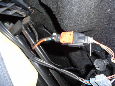

Exhibit A....This example is a Renault Clio under seat seat-belt pretensioner link. It has a stupid red plastic bit but I havent yet worked out how to pull the connector apart. Haven't worked out the secret combination of what to what to lift up/press down/slide out or whatever.
There are never any instructions and I have failed the initiative test!!!!

Found the answer and have undone the connections.
Key message.....leave the red plastic tab alone
I will put a link to this on the Renault Section.
The other connector requires sliding a yellow plastic "tab" outwards, just to lull you into thinking you need to do a similar thing with the red plastic. Don't touch it!!! it will break!!!This account from jimbutterworth.co.uk comes up with the goods
http://jimbutterworth.co.uk/5seats.htm its from a Peugeot 1007 but it is the same connector type just green rather than black as on the clio
pic shows how to undo connector
when its apart it looks like this
