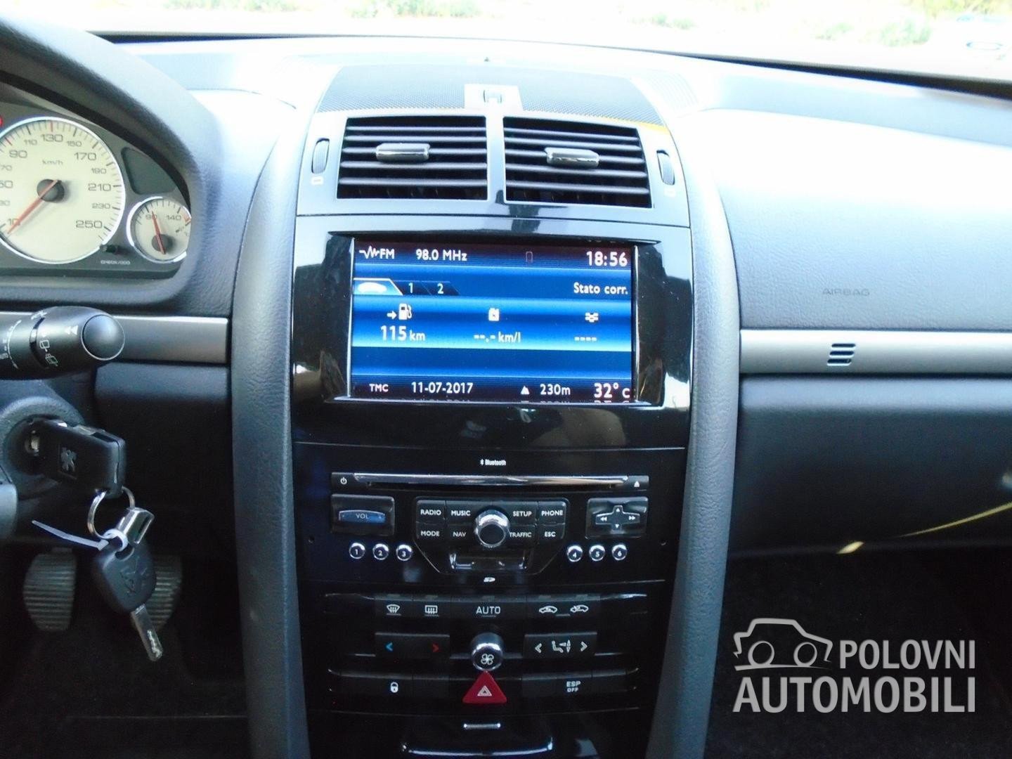

I have to reopen this topic because i stumbled on Harmen Becker navigation which is showing all parameters as consumption and other data. How this is possible. Is it somhing which can be enable trw BSI. Thanks

If you have the C5 then the consumption data is shown in your instrument cluster and it is not necessary to see it on the big screen too. You can enable it with lexia but it doesn't work properly due to the car already having the consumption data on a different screen.

Also, please note that this can have a bad effect on your car because there are differences between the Peugeot and Citroen architecture and how they display the data as Elis says. If you try to enable this on the C5 you can cause all the dash lights to start flashing everywhere - I already had to help one member get it back to normal after he thought he bricked his car!

Sorry - I'm confusing myself - what I said is correct - but this again was for a C5 X7 where the person was trying to enable extra info on the colour display that is supposed to be displayed on the secondary dashboard colour display.
I forgot you have the Peugeot 307 and in the picture that is also a Peugeot - so the settings in this car may be correct to display the consumption data on the large colour screen.
Whatever you do, write down any settings before you change them and remember what section of Diagbox / Lexia you are in as there is no reset and no undo feature.

No you are absolutely right i have Citroen C5 X7 2012 and i will not mess with Lexia and enabling that kind of option so i dont mess everything. So do you probbubly know if usb box can work on RNEG Herman and Backer
