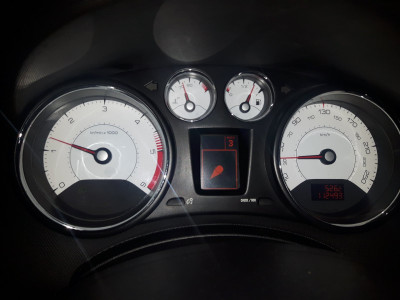

Have recently bought my 11/2012 Peugeot 308 e-HDI and a few times now it has come up with the attached photo symbol.
Can only be described as an ice cream cone with a scoop of ice cream on top.
Any ideas what it may mean?
Have obviously checked all possible handbooks and have tried googling to know. Got over hundreds pages with information, also asked official Peugeot service but no clue about this symbol.
A couple of times it's has pointed in another direction or upwards towards the right, if that makes sense.

This pointer pops up when "unmapped zone" is shown on navi screen and is different arrow than compass arrow.
In order to solve this I did upgrade from 2.85 to 2.86, not from lower FW. Generally everything works fine and only thing I found after that is parking sensor sound level, looks like have been lower.
It is like the system cannot find something and shows the direction how to get there.

I want to update you with the situation with my "ice cream" on instrumental display.
The issue is solved!
Everything was coming from not properly done settings ... as you said in your posts :)
My type is a 16-character matrix display and doesn't show street names, the settings were with street names and was making some conflicts.
Because the unit was taken from RCZ, the option in DiagBox were only 16-character with street names or no navigation instructions. For my BSI the system gives three options - 9-character w/out street names, 16-char. w/out street names and 16-char. with street names.
Thanks to MiraScript and the guy behind this app, I managed to change it easily (w/out going to Peugeot and making totally new calibrations) to my settings and everything works fine now.
