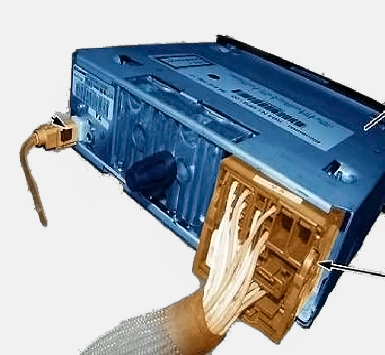

Ok, so you have the standard RD4, without CD Changer, or hands free kit, so what you will likely lose is the ability to change any units of temperature for example / speed and if it is like the other vehicles, the ability to see any basic diagnostic errors / faults that can be retrieved using the menu option. Also the RD4 can configure some options like auto lighting, and some other options depending on equipment, but I see from the spec. that this is a basic no frills model - so shouldn't have any other diverse consequences.
You'll need this type of pin removal tool and make sure you disconnect the battery before removing the radio - to reduce risk of damaging the screen display.
Once you have inserted the pins and carefully pulled it out, just disconnect the quadblock first and then the aerial.
You may need an adapter harness for the new radio, just make sure it is for PSA vehicles with RD4 and you should be fine.
