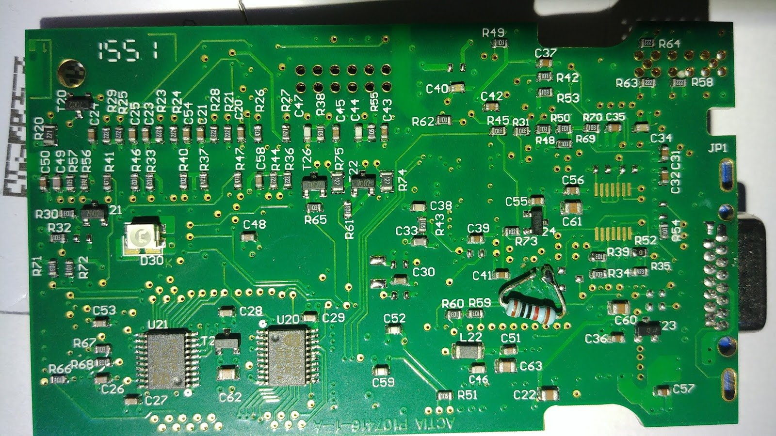

I have managed to rule out, or maybe narrow down my issues...
I tested my Virtual Machine(VM) Diagbox 7.02 / VCI 4.3.0 on a friends Peugeot 407, and it works!? (I'm excited to get my first ever 32bit VM running on 64bit Win 10, but annoyed I've faffed with many installs when it worked all along, just not on my car :()
I had also bought a £4.25 ELM27 OBD2 reader and that does actually work on my C1's port. I can read most of the live data and faults in the Torque App, but after about 6 fresh installs of XP and Diagbox in various ways, it turns out that was never the problem (I guess) as it does work on the 2012 407 just not my 2007 C1, and I know the VCI also used to work on my 2009 Dispatch.
Could it be I have a non full chip reader, or can my port be malfunctioning on certain pins? There is 12v on pins 4/5 to 16 are there any fuses I should check or specific pins for data transfer?? Another thought, could Diagbox 7.02-7.04 be broken for the C1? Now I know my VCI works I'll update to maybe 7.62<< that's best before telecoding was removed more and more I think?
*EDIT -- UPDATE: Installed 7.57 and still no communication between C1 and VCI
I don't think my VCI is full Chip, it seems to be missing a 10k resistor as some do? :
I soldered on a 10k resistor as recommended on another forum, but it still doesn't work, really frustrating after all this time wasted, think i'll have to find a real full chip board somewhere else.
Don't buy Lexia Diagbox VCI from VehicleDiagnosticsUK on Ebay as it's not a real full chip, and he doesn't answer emails.
Al
