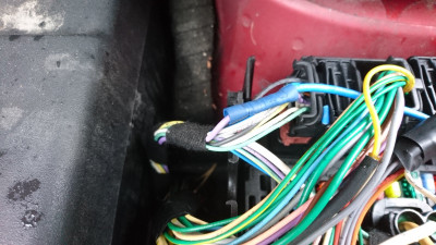

Yes, the two wires in your photo were connected with a fused bridge by the auto electrician and heater and air con then worked - but no delay when ignition was switched on. Can't remember the size of fuse - but should be the same as the heater fuse in the BSM, 15 amp??
When I eventually replaced the fusebox I simply removed the fuse and left the bridge in place - for the next time the fusebox fails.......

Re: C4 heater/air con not working
Hi again,
Am I following instructions correctly?
I unplugged A from B and bridged connection A using a 30 amp fuse. My understanding is that this should have bypassed the fuse box and its relays providing the entire ac/blower set up with current. However all I got was an ABS and ESP fault message
The auto electrician bridged the two thick input wires - yours seem to be yellow and white? - with a fused wire (of similar diameter). However the plug was still left in the socket. If this does not work then the fault must be further down the line.
Just to be clear the bridging was done by splicing into the two wires.......
Thank you for all your advice and patience. I gave the above a try and all seems to be working again.
I will run the temporary fix until I've sourced a replacement fuse box.
The first 4 pics are the under bonnet fuse box, and as you can see someone has been there before me.
My intention was to bridge the 2 thick wires but not sure why the additional 40 amp in line fuse is there.
The last 2 pics are the in car fuse box and you can just see that 2 wires have been cut and soldiered but no additional wires.
Any help greatly appreciated
Spliced the wires with an inline fuse and we have everything working again.
Thanks for all the info, really helpful
