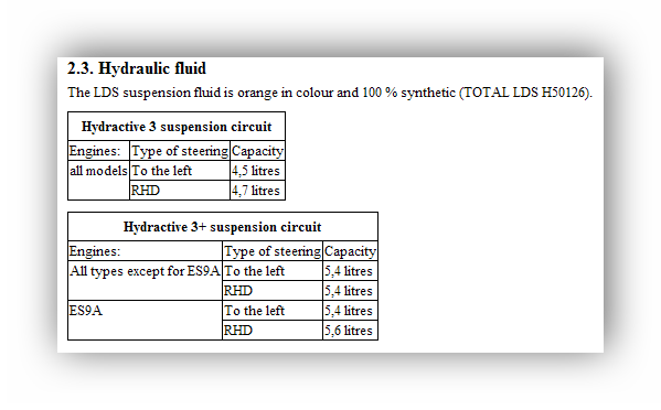

Does anyone know how much LDS oil is needed to fill up the tank after draining?

x 2941
Re: Citroen C5 - Changing LDS fluid
This do?
Posts: 28637
x 5651
Cupi34 wrote: 18 Jan 2018, 15:54 Does anyone know how much LDS oil is needed to fill up the tank after draining?
When all mine leaked out I put 4L in and it wasn't enough.
