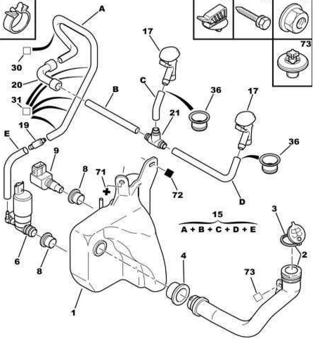

Here's a couple of diagrams for the front and the rear washing circuit / pipes etc.
Front Rear The pump is Part number: 6434 75 for your C5 Estate (item number 6 on the diagrams). Assuming it's not a kinked pipe anywhere - there could be some crud or scale in the pump, but at these prices it probably won't break the bank to replace it.

The reservoir is down in the offside bumper area. It is likely there is a valve in the line somewhere to make sure the water does not flow back down (so you will have water spraying when you require it NOW, not in a few seconds time). I have replaced the pump (you can get them from GSF for a few quid), and you could, once you get the pipes off the pump (don't get them the wrong way round), try blowing from that end, to see if there is a blockage (other than the valve).

I'm not sure but isn't part 19 in those diagrams the one way valve?

Part 19 just states Union Gibbo - and this model states 'sans clapet' for the pump (without valve) - It's correct for the VIN of this vehicle.

Part 18 might be the valve.

18 is a 2-way union.

That's what it is. It's just plastic, there's no one-way valve in it. That's the one near the corner of the bonnet.
I'll have to trace it back to the pump and troubleshoot from there. Is it a faff getting it off? Could you get under it from the wheel cover?

You will have to remove the forward plastic cover. It is not too bad, just a bit cramped. I wonder if the nozzles have valves in them?
