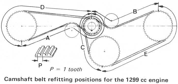

Hello I could use some help with setting my timing belts, I'm restoring my 1984 GSA 1300 motor and I bought new belts and tension bearings, I do not have a good manual the Haynes manual I have does not show the correct install of the belts, they have the white marks on them that I lined up with the marks on the cams and the main crank.
when I go to hand turn the engine it only goes a little in each direction then dead stops, so I know this is not right? does any one know what I'm doing wrong?
