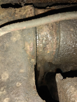

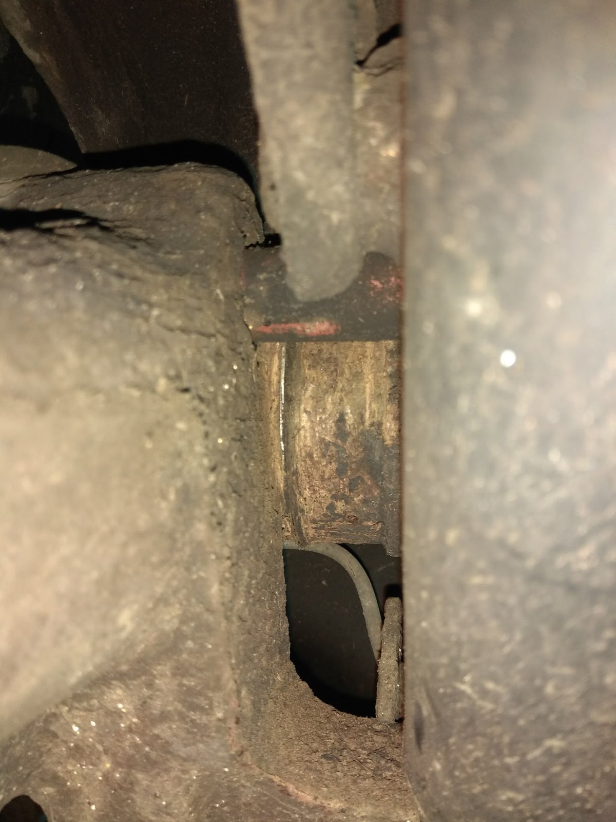

I got the car up on the lift today and had a look at the rear axle bearings.
Driver Side (Rear facing) Driver Side (Front facing) Passenger Side (Rear facing) Surprisingly, it's the drivers side that looks worse. Doesn't look too bad, does it? When car was on ground the gaps were not any more pronounced.
I suppose that this would not be causing the banging noise and they would be the mounts causing that - got a full set of them to resolve this.
I also pulled out the crud guard on the PS rear disc as it was fouling. I'll remove it totally when I go fix the axle.
Also, stuck in a side light in DS. Bit of a pain, but not as bad as the PS to work on.
Last thing was to try and fix the creak in the door. Removed pins and covered in copper grease and retightened. Still creaking so must be the check strap. Looks like a replacement required unless someone here can tell me how to fix the strap? Is the correct fix to replace the bracket and pin with Bracket & Pin

- Posts: 9313
- x 1938
Re: Xsara Squeaking/Creaking Rear suspension
No photos showing for me. Are these (supposed to be) uploaded here or have you linked to a hosting site?
