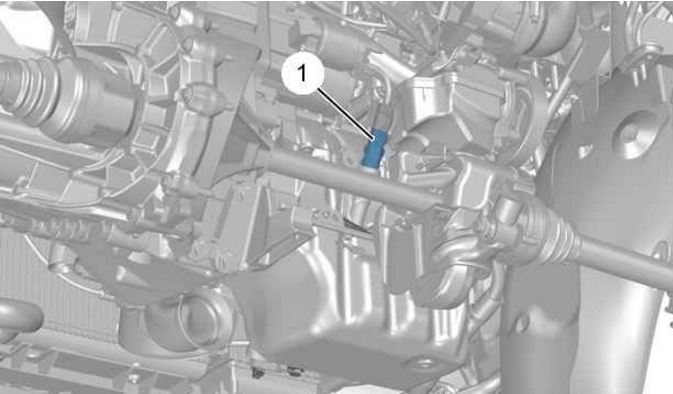

So the first thing I would do is check the actual connector, use a little electrical contact cleaner and check the pins / wires are ok before anything else.
Component number 15 on the diagram and Citroen part number is 1131G2. They cost £72.42 new inc. VAT from Citroen UK.
Here's a link to one on ebay so you can see - the same part number:
https://www.ebay.co.uk/itm/Various-Citr ... SwbtNaGYmx

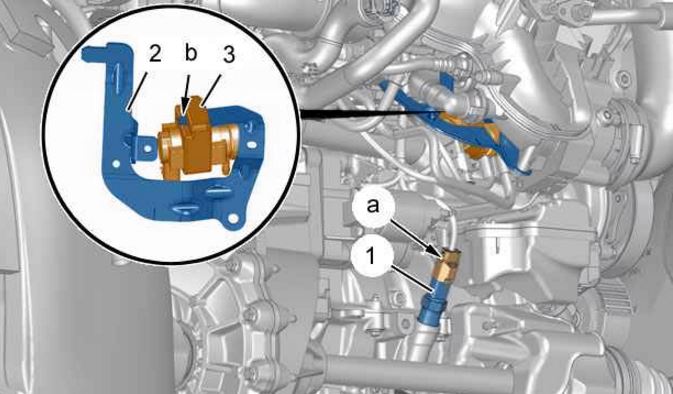

So Here is the location of the sensor - this one is both a temperature and level sensor:
Removing
Obviously, wait for the engine to cool down first.
Place the vehicle on a ramp, disconnect the battery & remove the under engine protection.
Refit the engine oil level and temperature sensor (1).
Connect the connector (Engine oil temperature and level sensor) ( as "a").
Clip the canister purge electrovalve (3) on its support (2).
Refit the under-engine protection.

Removing
- Unclip the canister purge electrovalve (3) from its support (2) (at "b").
- Release the purge canister solenoid valve (3).
- Disconnect the connector (Engine oil temperature and level sensor) (at "a").
- Remove the engine oil level and temperature sensor (1).
