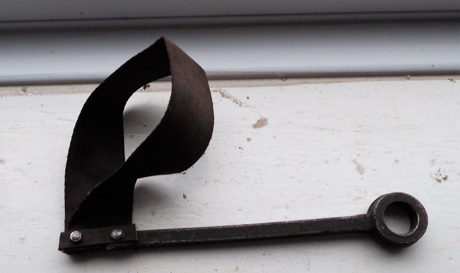

I used an old seat belt to make a webbing filter remover, cut it to the right length then bolted it to an old jack handle, must have done good service for more than twenty years now.

I made a similar item some 35 odd years ago. I bronze-welded a duplex timing chain onto an old 1/2" drive socket. It worked perfectly until I mislaid it one final time.
x 1746
Re: Snow good!
Done the same, with seat belt webbing slotted through a slit cut in an old long socket tool. The webbing tightens on itself as the tool is wound up.
Having used chain and strap wrenches for many years, I must say I do now like using large diameter filter sockets. Minor disadvantage is needing to stick to a chosen make/type of filter which the tool fits.

My strap tool has a 1/2" square drive hole and a 21 hex head (for a 21 spanner). I will get some suitable webbing and replace the failed webbing. I will try to get the stitching done, then folded over and done again (assuming that this will still pass through the slot). I will strongly suggest (based on what happened to Michel on that BLOODY filter!) you make sure the stitched section is in the slot when using the tool, as it was mainly the stitching that failed. If the stitching is in the slot the overlapping webbing should protect the stitching from being over-strained.
