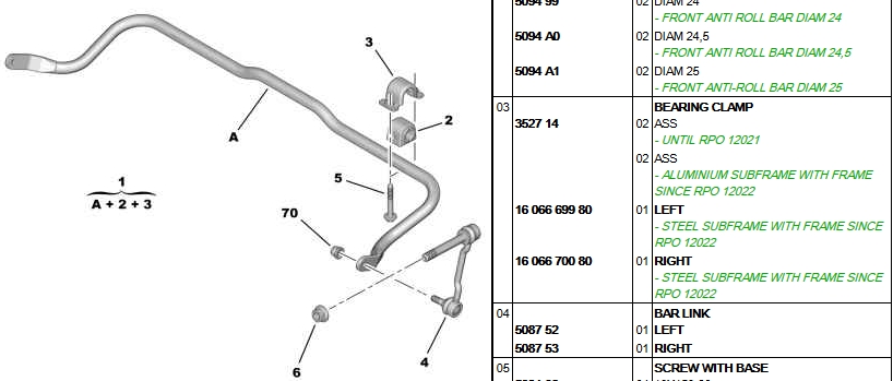

Probably p/n 5087 52 for the left one and 5087 53 for the right one - though a VIN would be useful for proper confirmation
There's no obvious signs that one is worn - they may clonk a bit going over bumps, but you can rarely - if ever - detect any play in them when you wobble them.
Part number 4 below
Part number 4 below

If it is the drop link and you're doing the job yourself, knock the long threaded section out of the suspension unit with a long 1/2" socket extension bar. They're usually the right diameter and you can knock the link all the way out and leave the extension bar in place to keep everything lined-up - it makes it easier when you come to put the new drop link back in.

A word of caution - it might not be the drop links ! They're a very common failure, 50k lifetime +/- 20k (??), but there's a few other things that can go clonk in the suspension as well !!

Clunk front 90% chance it is the drop links on all cars
Clunk rear, 90% chance it is the Radius Arm Bearings on Mk1/2 and roll bar bush on the X7

Replacing drop links isn't particluarly challenging - with a bit of practice you should be able to do both sides within an hour including two cups of tea and cleaning up - going from wheels on the ground, do the job, to wheels back on the ground.
