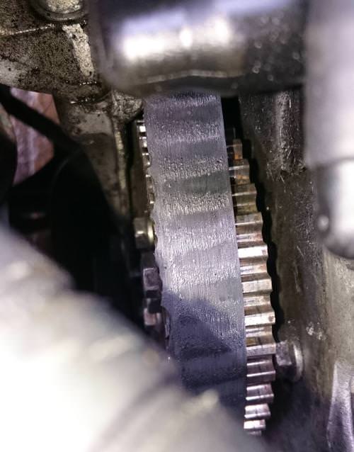

Took my timing belt cover at the weekend to see my timing belt on its way through being destroyed. Glad I caught it in time! I can't see any evidence of rubbing against the topmost timing belt cover.
This belt was only fitted about 3 months ago, along with a new water pump and lucas-to-bosch fuel pump swap.
About a month after the belt and pumps were fitted, the fuel pump had a bit of a leak. I took the cover off then to check on things and the belt was dead centre, although had a bit of a left-to-right wobble on it.
The same garage that fitted the belt sorted the leak in situ and put the cover back on.
What can cause this? Is this likely to be the garage's fault?

First suspect for me would be one of the idlers or tensioner running out of true. Either that or something obvious like a loose mounting bolt on the fuel pump allowing it to sit at an angle under belt tension.
Has there been an obvious noise coming from anywhere along the belt run?
The general consensus seems to be that not changing the tensioners along with the belt is a somewhat false economy from what I've read.

Difficult to see from the pics but something looks very wrong with the back of the belt, i wonder if you have a idler or tensioner breaking up? It needs stripping down and assessing correctly before further analysis can be made. Or finger pointing could be done! A multitude of things may have gone wrong including faulty parts - far from unheard of.

That does look as though the belt has been getting dragged over something that doesn't want to move...hard to tell if it's just a trick of the photo, but it looks to be going onto the pump at an angle.
If the garage have done all the work on the belt and it's associated pulleys, idlers etc I'd show them what's happening first and see what they say. I'd certainly not start taking things any further apart before you've spoken to them in case they accuse you of causing the issue.
Goes without saying as well, don't run the engine with it in this state...

Zelandeth wrote: 04 Dec 2017, 17:53 That does look as though the belt has been getting dragged over something that doesn't want to move...hard to tell if it's just a trick of the photo, but it looks to be going onto the pump at an angle.
Those marks I think are just deposits from my oil/fuel leaks (I still have a bit of that going on). Although I guess that would be consistent and not banded like that. I notice though the bands are wider to the left than they are to the right.
I might put my finger across them and see if they smudge.

Well I checked what those stripes are on the belt and they're not residue from fuel or oil as I suspected. They're definitely scrape marks.
Maybe it is a dodgy pulley or something.

Did the garage replace the water pump at the same time as the belt/tensioners?
I ask as often the change of stresses that result from a belt change often causes the water pump to fail. If it has and its bearing has collapsed it will definitely pull the belt off-line...
Else that, an idler or tensioner roller has been incorrectly fitted and is sitting at an angle... It could even be an idler roller bolt has sheared through over-enthusiastic tightening and again, a sheared bolt will cause a roller to run off-line...
Basically, here you see on the cambelt exactly the same as what happens when an auxiliary belt tensioner fails...
I'll be watching with interest to learn the root cause of this...

I wonder if there's mileage in getting a socket on the crankshaft pulley bolt and slowly turning the engine over by hand and seeing if you can see/hear/feel the cause of the problem. My money is on a seized/collapsed tensioner pulley...very curious to see confirmation though.

Zelandeth wrote: 04 Dec 2017, 14:01 ....loose mounting bolt on the fuel pump allowing it to sit at an angle under belt tension.
is the bottom bolt on the pump on the DW8 as difficult to get at as it is on the XUD? ....am guessing is likely as understand them to be similar engines. Garage might've not bothered to tighten it causing a 'slip'
There's a post here somewhere on the Forum from me relating to how to get at it reasonably painlessly (amounting to a shortened ratchet and extensions / adapters to just over 'pump body' length)

Pug_XUD_KeenAmateur wrote: 05 Dec 2017, 14:24 is the bottom bolt on the pump on the DW8 as difficult to get at as it is on the XUD?
My pump is from an XUD9 and I understand them to be identical between the two engines, so I assume so!
Before I put it all back together I looked at where the bolts might be. I was able to locate three between the sprocket and mount, and none of them looked especially awkward with a spanner. Maybe I'm missing one of them. How many are there meant to be?
Edit: Looks like the three I saw was all of them:
Maybe I'm being naive about how simple they are to get to?
