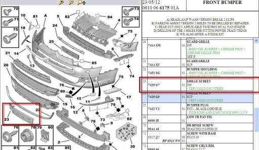

One of my earlier cars (can't remember now whether it was the XMs) had a sliding part that you could use in winter to keep some of the colder air out.
These additional grilles on the X7 are referred to as a snow guard - mainly intended for use in the colder snow-bound countries (note the "Very Cold Countries") proviso on the parts description - as you wouldn't want to fit and forget to remove it. This from the manual:
£32.58 Inc. (7429 G7)

Re: Citroen C5 X7 - 2.0 Hdi 138hp - MPG
GiveMeABreak wrote: 03 Dec 2017, 19:50 These additional grilles on the X7 are referred to as a snow guard - mainly intended for use in the colder snow-bound countries (note the "Very Cold Countries") proviso on the parts description - as you wouldn't want to fit and forget to remove it.
That is the one of the reason I have only bothered with the lower (bigger) guard, and never ever had any problems with over heating, even siting in traffic, and my car has the front engine under tray intact.
