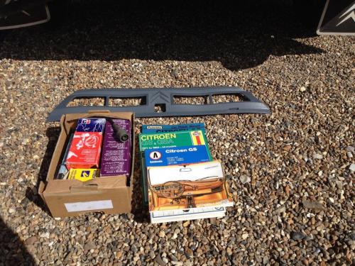

Anyway, what I am talking about is a plastic cover that clips onto the front grille to reduce airflow, therefore, speeding up the time the engine takes to get warm and maintaining the temperature easier, or Citroens description "VERY COLD CLIMATE SCREEN Removable protective screen which prevents the accumulation of snow at the radiator cooling fan" the other benefit is that it will stop road salt and grit getting to your radiator and a slightly better MPG - too, as the engine runs warmer
Well, I have just had one delivered for my C5 (X7) and will be fitting it when the ambient temperature on my journey to and from work stays below 10 degrees for a couple of days, next week probably, as I travel about 14 miles each way at either 6:45 and 17:00 each day.
Citroen instructions are "Do not forget to remove the very cold climate screen: - when the ambient temperature exceeds 10 °C, - when towing, - at speeds above 75 mph (120 km/h)."
Citroen "Cold climate screen"

I got the part number from the on line parts catalogue and ordered it through my 'Friendly' Citroen agent, delivered was just over £30. When I ever order a part I give them the part number and ask them to check that it is the correct part, now I was a bit surprised with this one as it only covers about 80% of the lower grille, it does not cover the air conditioning cooler on the left of the radiator.
Answering some of the other comments above, "The Diesel engine" requires heat to work efficiently, and a lot of it, so, if the ambient air temperature outside is 10 degrees, and your are travelling a 60 mph the wind-chill factor will be something around -3, see the chart below, this cold air blowing through you radiator and over your engine will have a very good cooling effect.

GMB - The part number is 7429G7 - Grille Screen, I use a Citroen dealer in Chorley for most 'waitable' parts, good service & postage and competitive.
I hope that helps, I have not fitted mine yet, still too warm, but won't be long.
