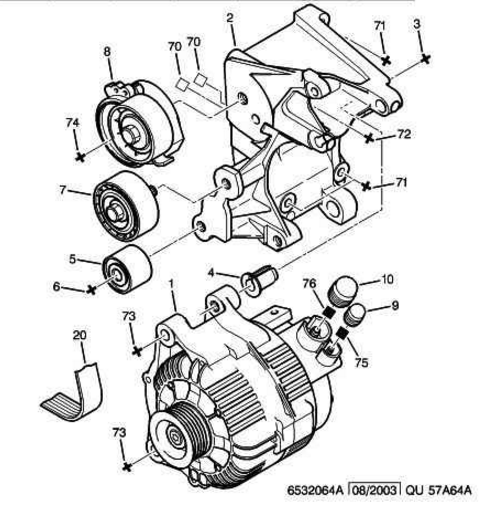

Ken - I'm not sure if I have your VIN, (ending 443?) but there are 29 (!) types of alternator for this vehicle. Anyway, looking at the generic picture and fixings below they state the main ones as:
(5) Retractor Roller
(7) Retractor Roller
(8) Tensioner Alternator
(70) Pin

GiveMeABreak wrote: 08 Nov 2017, 23:30 Ken - I'm not sure if I have your VIN, (ending 443?) but there are 29 (!) types of alternator for this vehicle. Anyway, looking at the generic picture and fixings below they state the main ones as:
(70) Pin
I do have the VIN, and just discovered tonight that I should sign up to Citroen's service site, not Peugeot's. I assumed Peugeot would recognise Citroen VINs, but evidently not.
I did see the ridiculous number of alternators, but now I've inputted my VIN I'm down to just this:
Struggling to see what's what on there without the context of the belt, but it does appear that (7) is the tensioner roller, and would be in the middle.
This seems to be in contradition with this diagram I found (mine looks like top-middle without the AC):
I remember that middle roler just wouldn't budge.
Do I have anything to lose by trying a spanner on the top one?

looks like you have to slacken bolt 77 then either loosen or tighten the nut at the top of the rod at number 8 to loosen/tension the belt.

wheeler wrote: 09 Nov 2017, 10:43 looks like you have to slacken bolt 77 then either loosen or tighten the nut at the top of the rod at number 8 to loosen/tension the belt.
Finally got it.
This was the solution for mine, although even with diagrams I was confused. I was mistakenly looking between the timing belt cover and PAS pump. Had to go to a garage to ask where it was, which he showed me for the price of a coffee.
For anyone else struggling like I did:
First slacken the tensioner using a 10mm allen key just above the tensioner
Then turn the nut just in front of the fuel pump anitclockwise:
