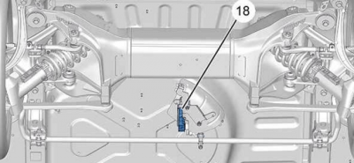

On later C5 X7 4-cylinder models there is one height sensor front and two on the rear axle - at least on HDi180 model.
- x 6955
Re: Xantia front rises on full lock
Show me please - that's not documented anywhere that I can see. Only ever one on the rear and one of the front for 4 Cyl models in the docs.
Found it - though not obvious there is a right and left one mentioned - so we can now add this to the above!
It shows a left and right sensor but just one pickup, so wondering if this unit combines the 2 or there are 2 of these as well? Very interesting as to why they decided to make that change so late in the day..... well spotted Xantippa.
