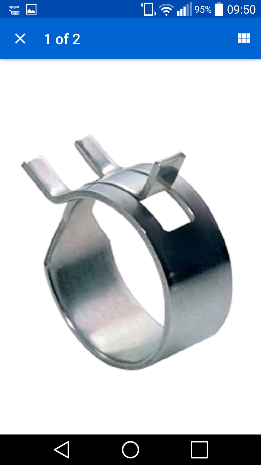

Ahh those... The Laser tool will work on those too or failing that I use a pair of locking pliers...
Like these:
Bahco Locking Pliers
I love mine and find them indispensable for many jobs...
Like these:
superloopy
- Posts: 3344
- Joined: 30 Mar 2005, 03:25
- x 19
Re: Xantia 1.9td air ingress question ...
Tried pliers but the jaws dont open wide enough and they keep slipping off. Think i'll swap over to those ring clic clamps although i'm not convinced they 'bite' enough to prevent air getting in.
No, normal pliers won't do Mike... I've told you what tool you need to deal with them
I feel more confident using clic clips than any other alternatives and they're so quick and easy to remove and refit.
- Posts: 55170
- x 8437
MikeT wrote: 08 Nov 2017, 14:34 I feel more confident using clic clips than any other alternatives and they're so quick and easy to remove and refit.
Agreed... I like them on coolant hoses too
I like them, provided I am tooled up to deal with them, large pliers, locking pliers, long pointed ones, I had a few goes with the proper tools, ok as long as you can bring them to bear on the clip, a friend has one on a short flexible cable, you would need a set.
A mole wrench can work well on those spring-wing clips. They open wide, can also grab the clip from the side, and will lock.
I'm going with clic clips for each pipe i swap out but sizing is an issue. Do i just fit clips which match OD of each pipe exactly and will clipping them form a good seal? Sounds daft but the specs for each clip and there's many, seem to allow for a couple of mm expansion. For example, a clip is sized at 8-10mm, my pipe is 8mm OD, will it be as effective a seal on 8mm as it obviously will be at 10mm. I'm confused by sizing. I could buy a full set and just choose the tightest fit but buying individually theyre very expensive for what they are ...
