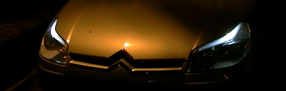

Excellent job Mike. They still stand out even when just sidelights are enabled. A huge improvement overt the stock bulbs.

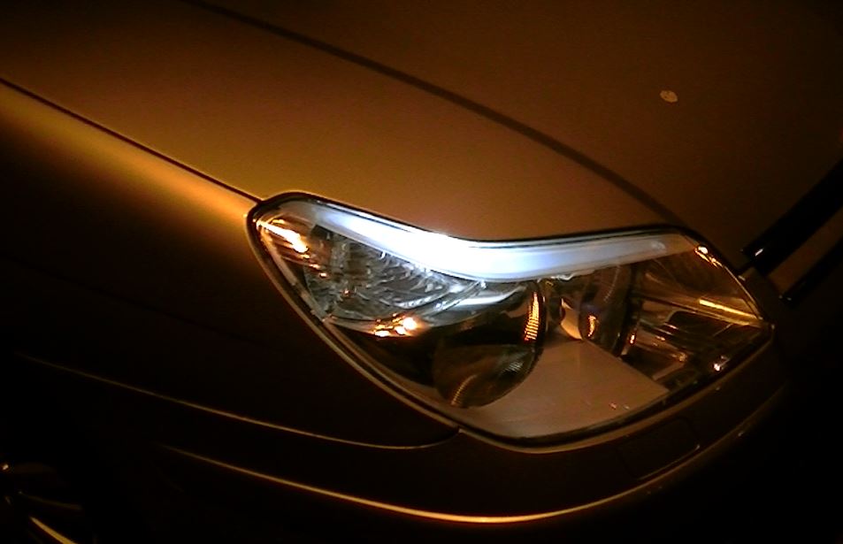

A couple of nightshots (albeit under strong street light) of just the sides.

Those sidelights look distinctly spooky in the pictures Mike! They are really good and artistic to my eye

Agreed Jim. Those night pictures were screengrabbed from my camcorder, far better quality than my phone.

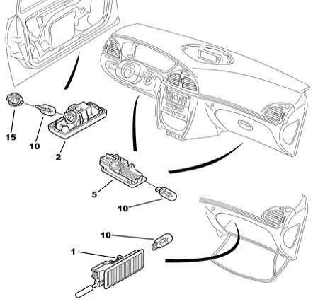

Ok for the Sill, Courtesy & Trunk lights - they are standard W5W bulbs, as are the Map Reading lights.
However the Vanity Lights behind the sun visors are a different story - they use a 3W bulb no longer supplied by Citroen - it looks a bit like a festoon - so you might need to leave those. For all of these I have replaced with the following type of LED: You need to check out the various suppliers, as they do vary considerably in length. The ones here are 15mm in length, by 5mm wide and 1mm thick. They are available in various colours for when you want to 'pimp your ride'
I used these in my X7, but your MK II fittings may be slightly different although the bulbs are the same - so I would do a quick reccy on the space you have available for fitting.

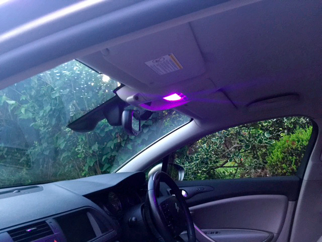

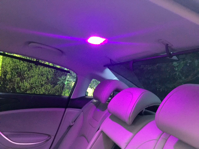

Here's a few shots from mine - using Ice Blue and Purple (yes I know...)

I do like a bit of ambience. I tried a colour-changing led festoon in my luxurious Granada cabin years ago which I found quite soothing. I believe you can now get remote-controlled RGB LED's now. I have those in strip-light form in the home and they are excellent.

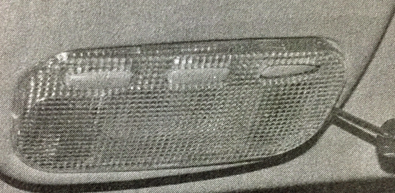

Marc, I don't suppose you know where the correct levering points are on these interior light lenses? I've got a phobia after accidentally levering the whole light unit out of another car once because it never sat flush again.

Regarding those lenses - I have to agree the lenses on the MK I & IIs are a nightmare to get off and you are in constant fear of breaking the damned thing.
No prizes for guessing where these fantastically high quality images came from...
The lenses are levered as shown in the second picture - in the middle, but you need a very thin flat screwdriver and then possibly a flat trim removal tool to help get the thing off.
