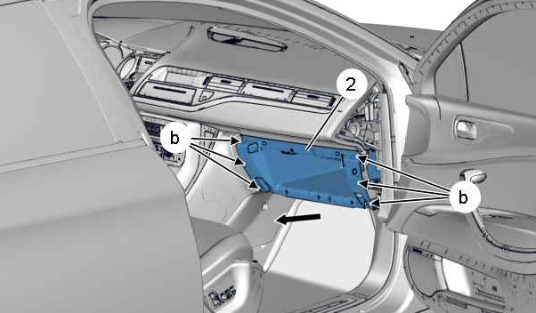

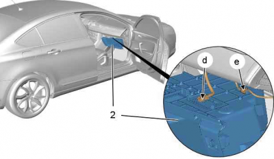

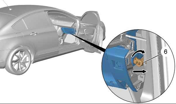

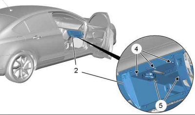

Hi and welcome to the Forum Gary. There are a few more steps to follow - but you'll need to disconnect the battery and leave the car for 10 minutes or so as you'll have to remove the passenger Airbag Switch.
- Make sure you have removed the light lens and connector
- Remove the 5 bolts shown at (3):
- Remove the bolts at (4) & (5):
- Unclip the glovebox at (b) and remove in the direction of the arrow
- Next turn the Ram a quarter turn following the arrow (note will probably be anti-clockwise for the left hand side). Then remove the ram.
- Disconnect the Passenger disconnection airbag switch.
- Disconnect the connector at (d) and the harness at (e), then remove the glovebox.

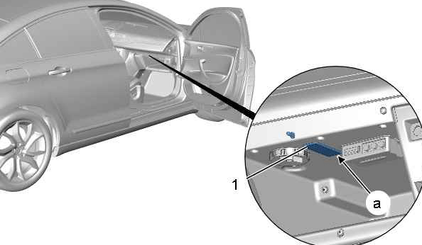

- x 6945
Re: Glovebox removal access blower resister pack

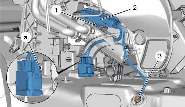

Gary, Post up your VIN or PM me and you can clarify which part it is you need to replace - depending on your climate control unit (mono / dual). I can help you with a diagram once you know which part it is. What is the actual issue with the heater?
On the Right hand drive vehicles you gain access from the passenger compartment - but I've replaced the Pollen / Charcoal filter without taking the glovebox off. This is where it is located 0 item (2). The 'Criss cross grid you can see to the left is the cabin filter cover which you can get to easily enough (legs upside down mind)!
Unclip the connector (a). The earth bolt is (3) and there is another bolt at (2)

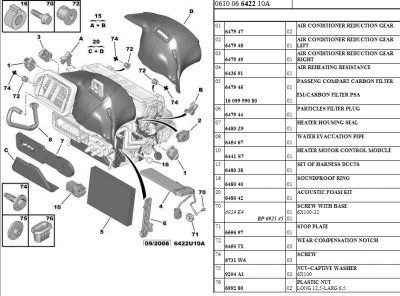

I've not received your PM, but below is the heater detail showing the parts. Are you sure it is the heating resistance? There is also the heater motor control module shown at (10). If you've had a burning smell, then something surely isn't right - but I would want to know the cause first of all. Anyway here are all the components for a Bi-Zone Climate Control Model.
Edit: Updated the Parts Diagram in light of VIN
(You have the dreaded Stop Start model Gary!

I see number 10 is the heater motor control module, but there are now arrows pointing to where it goes in the diagram. Sorry if I am being thick here.
Gary.
Gary.
