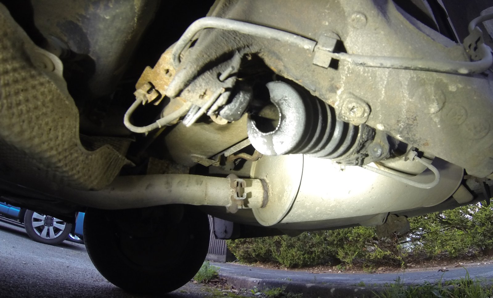

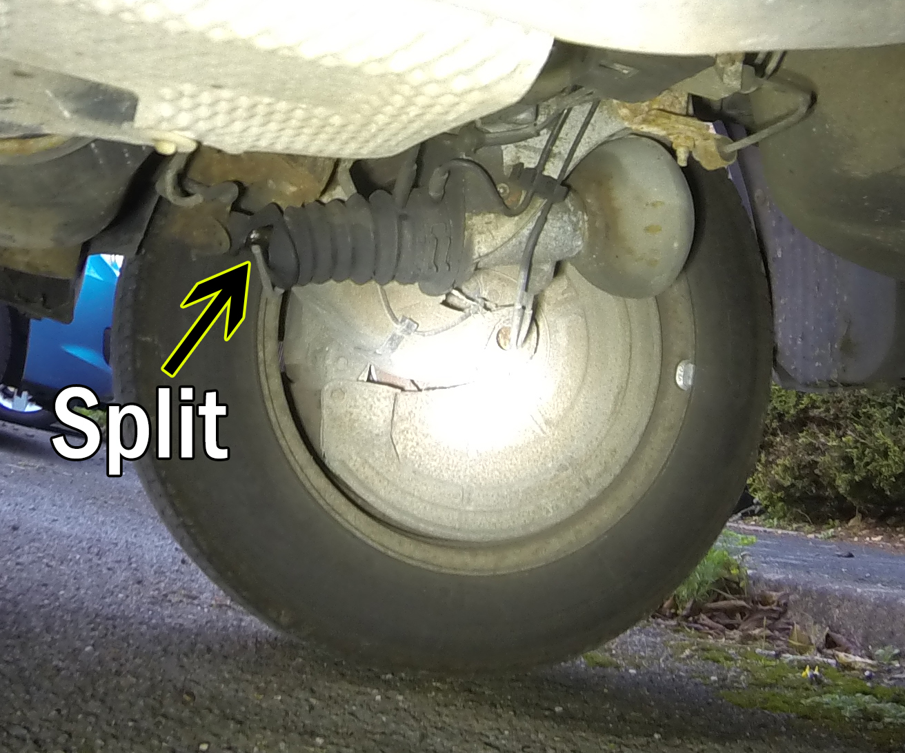

The first thing I was going to look for was the so called "bump stops" but I noticed something that looked a bit more desperate. I'm not sure what these (in the pictures) things are. They look like some hydraulic arm on the other side of the sphere.
Other than the rubbers being shot the one on the passenger rear side had some fluid pour out when I squeezed it. It wasn't much, about 1/4 of an egg cup but I assume that means an LDS leak?

Rear Drivers Side
Rear Passenger Side
Rear Passenger Side

I wouldn’t be too worried about the lds in the boots. It is normal for a small dribble of lds to be in the boots. Indeed, when fitting new boots it is advised to syringe a small amount of lds in. Just change boots and I bet they will be fine.

P.s it is quite likely that the bump stops will be missing. They fall of easily as they degrade. I tend to lose one a year. They won’t be the cause of the knocking noise.

Those gaiters aren't expensive.
I had one replaced a few years ago, it was £13.
It can be a problem getting the "R" clip out if the suspension arm to replace them though.
The gaiters should have LDS in them - it is returned to the reservoir through one of the two tubes attached - the other being a breather.
