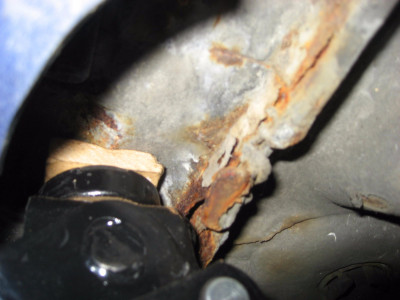

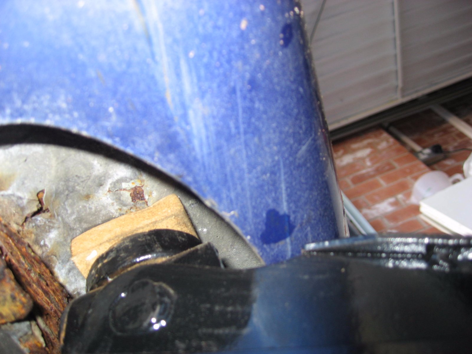

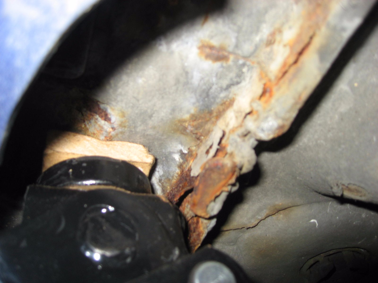

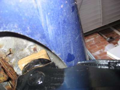

Picture of my actual low entry trolley jack in situ with car lifted using the Saxo jacking point [ note the cut back panel forming the shape of an ear].under the strengthened sill, note on this lowered vehicle when lifting from this particular jacking point the jack actually lifts the whole of the side, i.e. front and rear wheels off the ground, lifting this way puts tremendous strain on the vehicle whereas lifting a non lowered vehicle the rear wheels stay on the ground which puts less strain on the vehicle. Lifting with a trolley jack in this area under the sill [when wheel changing] personally I would not recommend,far better to use the chassis and distribute the weight
- Posts: 54549
- x 8058
Re: Jacking points Saxo VTR.
Looks like you have some serious rust there
I'd be investigating that and taking any necessary remedial action.

[quote=CitroJim post_id=558675 time=1511847370 user_id=4651]
Looks like you have some serious rust there :
Car is SORN, I have done loads of work to it.I need a temporary insurance next, and then up for MOT where any welding needed will be done, then I will put it back on the road. Really speaking it has lifted on all four jacking points with a trolley jack so it seems it is structurally safe, otherwise the jack would push through and penetrate the sill . However I take your point[s], however the objective is for these pictures to show the jacking points to the wider audience , it really is up to the person with the car whether they use them or not, personally I think it unwise for the reasons previously indicated..
