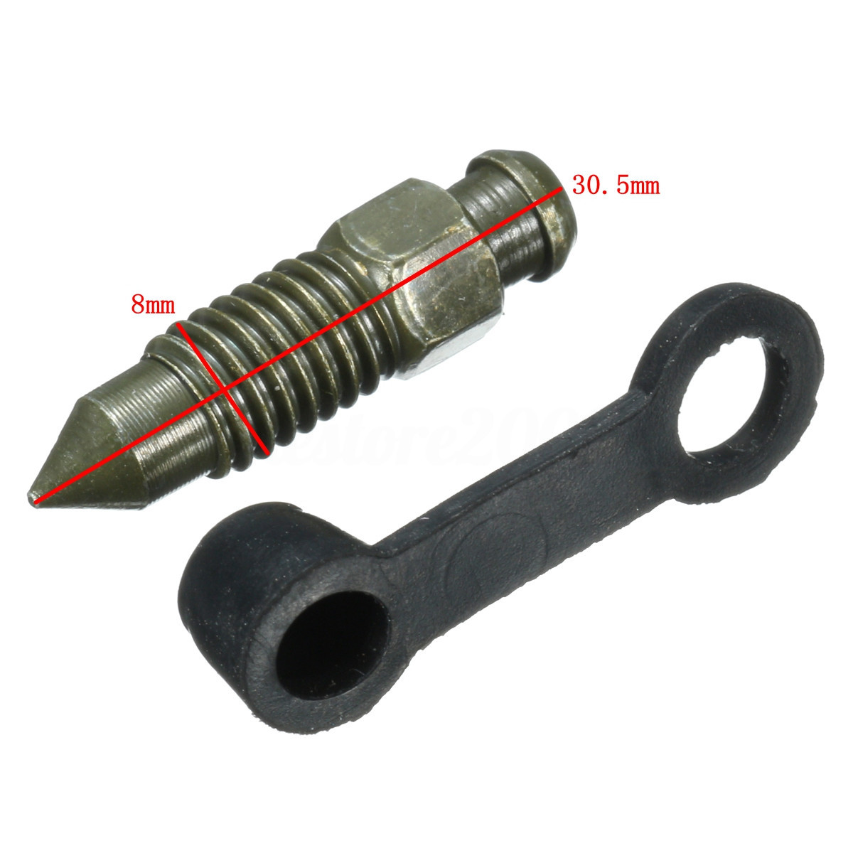

I obtained a set of bleed nipples from an ebay seller. They fit just fine and are inexpensive.

Have you actually installed those bleed nipples? they look rather like the one that is too short. It appears to fit when you screw it in, but the thread bottoms out before the point has sealed.

I did install the bleed nipples and they were just long enough.

Jan-hendrik wrote: 15 Oct 2017, 13:15 I did install the bleed nipples and they were just long enough.
Looks as if they are just long enough. The photo shows the threaded+end length to be c.20mm. My modified M8 bolt was 22mm, a dimension copied from the OE Xantia valve bleed plugs.

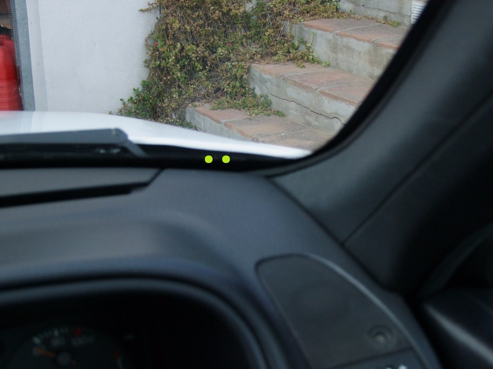

Good idea to fit extra diodes and a pair of monitoring LEDs. Can be done in one hit, as it's the same two pins/connections to the suspension ECU multiplug that are tapped into.
A recent idea for fitting suspension LEDs, without the need to take wiring through the bulkhead/firewall.
The LED pair could be mounted waterproofly in the wiper motor trench, under the scuttle cover.
Under-bonnet switch (LED ground-side) to kill when not needed.
