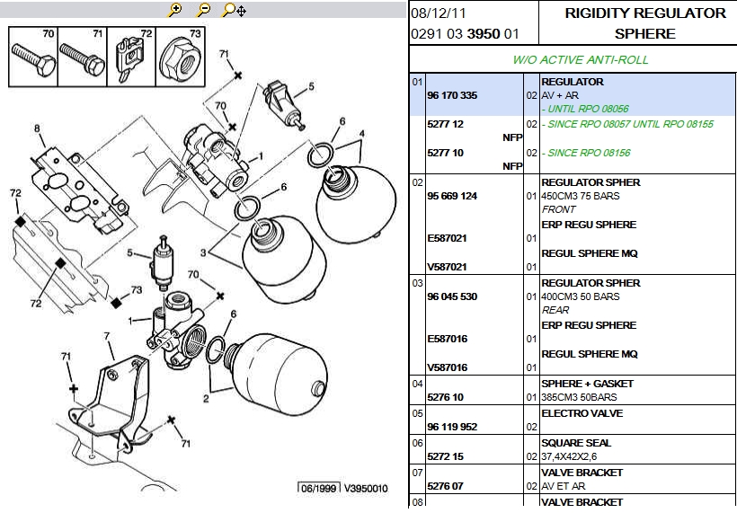

Part number ? Who knows... :) There were actually four versions of the regulator made according to that article:
1) Original regulator with two small pipes, old ISO fittings on the large pipes, used up until RPO 8051, (24 November 1998) so this will be by far the most common version since it was in use for 5 years.
2) "Interim" regulator from RPO 8053 (26 November 1998) to RPO 8154 (7 March 1999) which functions the same as the old regulator but has new "Citroen" fittings on the large pipe. This must be rare as hens teeth as it was only in use for 4 months...
3) "New" regulator described in this evolution. Fitted from RPO 8155 (8 March 1999) until the end of the Xantia's run some time around 2001, so there will be a fair number of these around but not nearly as many as the original type. It has both the new "Citroen" fittings on the large pipes like the interim regulator and the spring and modified internal piping.
4) "Replacement only" unit, presumably first made available in March 1999 with the old style Citroen fittings on the large pipes but the new internal piping and springing like the previous unit. Presumably they did a production run of these to have replacement parts available for cars prior to RPO 8053, but they would have never been fitted to a new car, and its likely they didn't make very many as the hydractive regulators very rarely if ever fail...
This replacement only unit is the one we'd want if we could get our hands on them at a fire sale... Fitting it would be a straight swap, you'd only have to blank off the no longer needed pipe from the anti-sink valve - in the service note they suggest to fit a bleed screw into the unused port in the anti-sink valve as a blanking plug.
