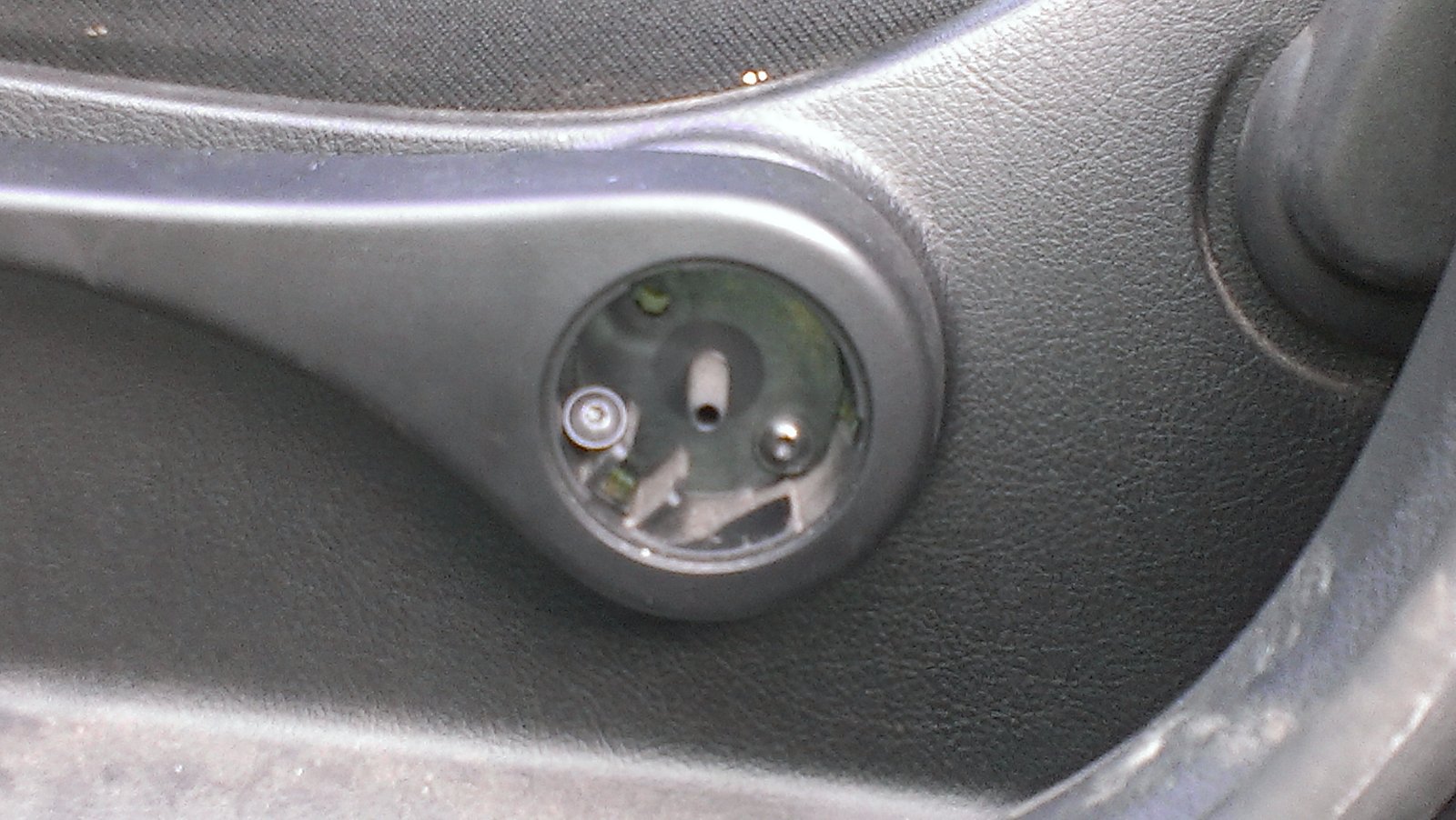

Seat height adjuster on the 307 was all floppy, I assumed as it is a long lever on the outside of the chair that one of the boys had stood on it getting in the car. However, a close look revealed some threads in the mouting boss, and a rattling handle :? so I popped the outer trim plate off, and found ...
Yep, 2 small screws, one out and the other loose. A quick dab of thread lock and nip them back up and all is good again! Now, where have I seen that before.... :rofl2:

That looks remarkably flimsy for what it has to do Richard...
And yes, There's a French saying for it isn't there that roughly says however much things change they always stay the same...
I'm thinking of Xantia seat height adjuster levers here ;) They are always loose due to the same (albeit a bit bigger) screws...
