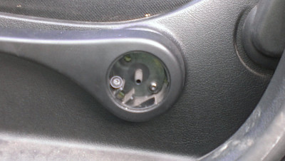

It seems PSA are unable to invent new ways for cars to fail....
Seat height adjuster on the 307 was all floppy, I assumed as it is a long lever on the outside of the chair that one of the boys had stood on it getting in the car. However, a close look revealed some threads in the mouting boss, and a rattling handle
so I popped the outer trim plate off, and found ...
Yep, 2 small screws, one out and the other loose. A quick dab of thread lock and nip them back up and all is good again! Now, where have I seen that before....

That looks remarkably flimsy for what it has to do Richard...
And yes, There's a French saying for it isn't there that roughly says however much things change they always stay the same...
I'm thinking of Xantia seat height adjuster levers here
They are always loose due to the same (albeit a bit bigger) screws...

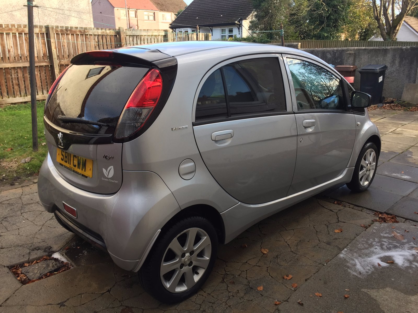

Yours is doing better than the old dishwasher that was in our house when we moved in - it sort of worked but had a leak, I thought I had the leak fixed, it worked for one day and then BANG!Then onto the dishwasher - been a long running saga with water collecting in the bottom. Some was certainly getting past the door seal - a new seal and cleaning out the bottom of the door seems to have fixed that. Turned it over and took the bottom off, but could see no obvious witness mark. Stood it back up and ran it with the access panel off - as soon as the water inlet was opened, a cascade down the side. Ah-ha! Took the top and side off, ran it again and water weeing out of an O-ring seal on a solenoid valve. Been leaking some time going by the crud on the insulation, but must have got worse recently. Took it out, no obvious sign of distress on the O-ring, just a bit hard. Wrapped a couple of turns of PTFE tape round it, shoved it back in and ran it again and bingo no leak. Pleased with that. Given that it's 15 years old, if it still leaks then it will get sealed in with silicone; if the solenoid gives up after that and can't be got out, the machine can be recycled!
Pics or it didn't happen.After that I WASHED my car
I'd let the Ion get really, really dirty recently to the point where it would have been in direct competition with yours,- well, it had got to the stage where the crud could be chipped off in lumps and you couldn't get in and out of it without getting flithy!
It does clean up nicely.
