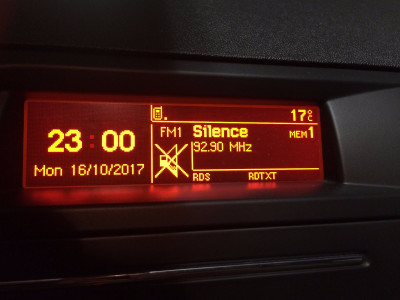

After some time I finished my fight with the RD4 -> RD45 upgrade! I was quite satisfied but after about 4-5 weeks of using new features I am facing new problem (probably related to the RD45).
My new RD45 radio stopped playing and it is displaying "SILENCE", please see picture below:
I can normally access to all the configuration menus, bluetooth settings etc. I cannot change the source, nothing happens when incresing/decreasing volume or inserting CD. Even, unmute button is not working What is interesing I can normally use the hands free kit, phone to everybody. I replaced the radio with my old one and everything is working well. That is why I believe there is some kind of software failure / bug and my new radio just hang up. I had similar situations before (mainly with pairing the equipment). Is there any possibility to RESET / reboot the radio? I tried to disconnect it from the car but it did not help. Do you have any ideas? Maybe software upgrade? How can I do it?

Can you confirm that you VIN coded the new unit to the car?
- mr_maras
- Posts: 16
- Joined: 18 Jul 2017, 17:02
- Location: Wroclaw
- My Cars: Citroen C5 III Tourer Exclusive (2008)
2.0 HDI 136 KM DW10BTED4 FAP
Re: RD45 questions + Microphone installation C5 X7 + Amplifier installation
Yes, I confirm that VIN is proper and telecoded. Normally, when someone is calling my phone during driving the radio is automatically switched to silent mode. I believe that it hang when someone was calling me.
Is there any way to reset the radio to factory default settings?

Do you have a Diagbox / Lexia? There are no firmware updates to the non-telematic head units as a rule, but you can perform tests using diagbox to test the functionality of the buttons, volume, mute and speaker connections etc which might help narrow the problem. Have you checked your connections are secure (even within the pins) at the back of the unit? It's possible that there is a comms fault.

I believe there is a way on the parameters menu of the radio to see if any of the steering wheel buttons are stuck down. This may cause all sorts of weird behaviour.

I will try to check what you suggest. But when I replaced RD45 with RD4 radio, the old one is working fine... I will let you know.
@Edit:
Every button is working fine. None is pressed all the time...
@Edit:
