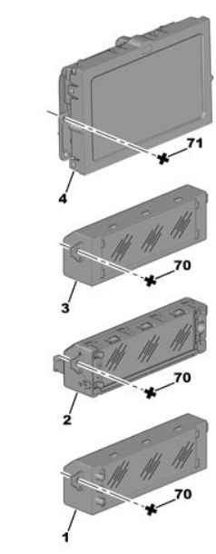

Re: RD45 questions + Microphone installation C5 X7 + Amplifier installation
Hi everyone. Like everybody I have problem with upgrading Rd4 to Rd45. Car: peugeot 207. Everything looks fine just bluetooth not working. Diagbox cannot communicate with hands free kit. My old Rd4 was factory fitted with separate Bluetooth/USB module. Mic Aux and USB wires from that module I moved to Rd45 radio. In Diagbox we activated usb-works fine. I cannot activate bluetooth. Maybe Rd45 foulty, even my android phone cannot find my cars bluetooth. Any ideas from what to start? Thanks.
- GiveMeABreak
- Posts: 37433
- Location: West Wales
C5 MK I 2.0 HDi SX Wicked Red
C15 Romahome White
XM 2.0 SX Polar White
CX 20 Polar White
GS 1220 Geranium Red
Hi and welcome.
I think your problem may be with the multifunction screen. There are 4 types of screen - 3 of them look identical - but the RD45 needs a particular one which is different to the one fitted with the RD4 standard unit. The correct one will depend on your DAM and options. If you have your VIN, I might be able to work out the right screen for you from the options. You will need either 1, 2 or 3. Obviously you already have one of these - so it may be one of the remaining 2. It is also referred to as EMF 'C' type screen.
