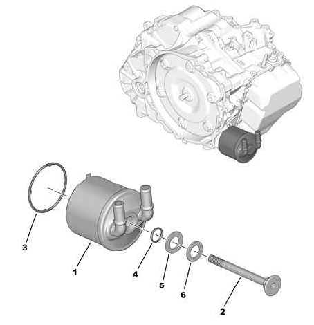

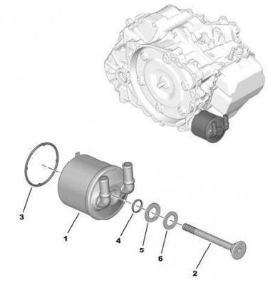

Thanks EDC5, so that little round 'tank' with two pipe connectors just below the control block is the cooler/heat exchanger and does both, heats and cools the gearbox oil.

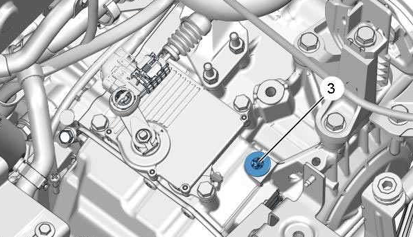

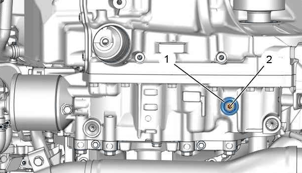

Here Stu:
You have the Euro 5 engine, so AW-1 oil.
Capacity is 7 litres of oil, 4 litres remaining after draining 3 litres using procedure.
The gearbox must be drained when the oil is hot (60 °C minimum), to eliminate the impurities suspended in the oil.
Procedure:
Draining
Put the vehicle on a hoist. (remember to raise suspension and remove LDS cap if suspending with wheels hanging free)
Remove :
The protective panel under the engine
The top-up plug (2) ; Using a TORX socket wrench
The oil overflow and drainage plug (1) ; Using a 6 -sided wrench
Approximately 3 litres of oil should flow out.
Refilling
Refit :
The oil overflow and drainage plug (1) (equipped with a new seal)
The top-up plug (2) ; Using a TORX socket wrench Remove :
The air filter housing
The filler cap (3)
Refit the filler plug (3) (equipped with a new seal).
Initialise the used oil counter (follow the diagnostic tool procedure).
Check the oil level
Prior conditions:
Stream of oil then reducing to a sequence of drips:
Refit the oil level plug (2).
Sequence of drips or nothing:
Refit the oil level plug (2) (equipped with a new seal).
Check the oil level (continued)
Refit :
The filler cap (3) (equipped with a new seal)
The air filter box
Too high a fluid level can cause:
Overheating of the fluid
Fluid leaks
Too low a level will lead to destruction of the gearbox.
Procedure:
Draining
Remove :
Refilling
Refit :
The filler cap (3)
Check the oil level
Prior conditions:
- Vehicle level
- Check that the gearbox is not in downgrade mode
- Remove the filler plug (3)
- Add 0.5 additional litres of oil in the gearbox
- Apply the brakes firmly and move the lever through the various selector positions
- Gear lever in position "P"
- Engine running at idle
- Oil temperature 60°C (+ 8 ; - 2 °C) (measuring of parameters using a diagnostic tool)
- Refit the oil level plug (2).
- Stop the engine.
- Add 0.5 additional litres of oil in the gearbox.
- Repeat the top-up procedure.
Refit :
The air filter box
Fluid leaks

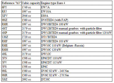

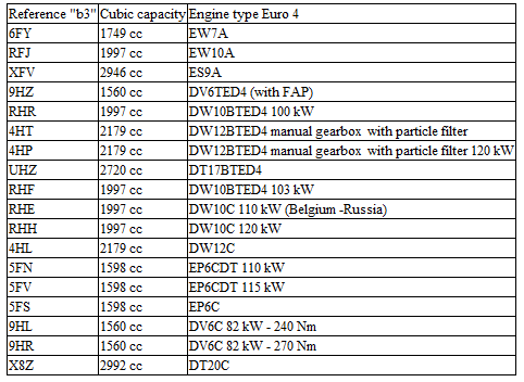

So I'm just going to throw this in for debate as I think it is relevant to this whole 'Euro' Engine / Emissions standard debacle.
[1] - The procedures state:
[2] - Next, regarding the PSA / Euro Designations
The PSA 'Levels' are not the same as the 'Euro standards' on some VIN specifications, so be careful. So where it says 'Vehicle Technical Depollution' or 'Emissions Standard (Engine)', the 'L4' or 'L5' does not correspondent to the Euro Standards. See the following table for equivalents: As an example - here is an extract from the relevant VIN specs, from two C5 (X7) DW10BTED4 engines. One is a 2008 and one a 2009 model. Note the first one (2008) refers to 'L5', but it is actually a Euro 4 engine. The second (2009) actually now states 'Euro 5' Although it might seem the engines are the same - they are not quite - the 2008 is an 'RHR' (100 kW) and the 2009 is an 'RHF' (103 kW)
[3] Now look at the engine codes table below
According to this table both the RHR & RHF DW10BTED4 engines (referred to above) are under the 'ENGINE TYPE EURO 4' Column.
So the wider question now is
Ok, so that makes sense so far.The oil type "AW-1" in AT6 and AM6 gearboxes with engine version Euro 5 is specific and cannot be replaced with oil type "JWS 3309"
- Are ALL these engines listed in the table actually Euro 4 engines?
- Are ALL these Euro 4 engines as a minimum, but may, depending on your engine code & VIN Specs. actually be Euro 5 compliant?
- Are we more confused now than ever?
