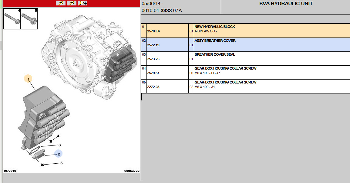

How to change the valve block, is it one block for all gears?
Where to by the oil from and how much, my car is a euro 5, so I will need AW-1 spec and not the Other JS3309 which is very expensive from Citroën and aparently they should not be mixed - Why is it just because of the euro 5 restrictions?.
Also, information about fitting an oil cooler would be great.
Talk about unlucky, steering rack and gearbox in the same couple of months :(
Thanks so far
Stu.
It this the part?

EDC5 wrote: 12 Oct 2017, 22:00 I'm not sure about the oil cooler mods to be honest. By sharing the cooling capacity with the engine it means the box is effectively warmed by the engine and gets up to operating temp quicker. I have seen an adapter plate on ebay that replaces the current cooler, so it can be done but I'm not convinced myself.
Thanks, however, looking on the service box site I can see where the cooler connects, I think (just under the hydraulic bloc) but I can not find the radiator - mmmm :?:

There isn't a radiator specifically for the gearbox. It's fed water from the main engine coolant loop. the "oil cooler" is actually an oil/water heat exchanger between the gearbox oil and engine coolant.
