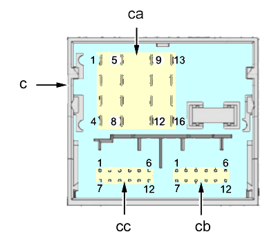

Ok to save some time, now we have the additional docs, here is the Pin info for RT6:
"ca" 16-way black connector (Without HiFi option)
Channel number Allocation of channels of connector
1 Rear right speaker positive control
2 Front right speaker positive control
3 Front left speaker positive control
4 Rear left speaker positive control
5 Rear right speaker negative control
6 Front right speaker negative control
7 Front left speaker negative control
8 Rear left speaker negative control
9 Colour screen power supply
10 Comfort CAN High
11 Channel not connected
12 Battery +
13 Comfort CAN Low
14 Channel not connected
15 Colour screen earth
16 Earth
"cb" 12-way black connector (Note: This is only with CD changer Option)
1 CD changer earth (*)
2 Comfort CAN Low : CD player(*)
3 Permanent supply : CD player (*)
4 Right audio system : CD player (*)
5 Channel not connected
6 Comfort CAN High : Remote control (*)
7 Comfort CAN High : CD player(*)
8 Audio earth : CD player (*)
9 Sound cut-off control (MUTE) (*)
10 Left audio system : CD player (*)
11 Comfort CAN Low : Remote control (*)
12 Channel not connected
"cc" Natural 12-way connector
1 (*) Video positive input 1
3 Microphone negative input
4 RH audio signal auxiliary positive input
5 LIN bus for screen DG4
6 (*) Video positive input 2
7 (*) Video negative input 1
8 Channel not connected
9 Microphone positive input
10 LH audio signal auxiliary positive input
11 Audio signal auxiliary negative input
12 (*) Video negative input 2
(*) According to version
| "c" 40-way black connector : "ca" 16-way black connector "cb" 12-way black connector "cc" Natural 12-way connector |
10 Comfort CAN High
12 Battery +
13 Comfort CAN Low
16 Earth
