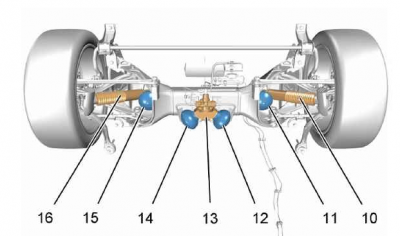

C5s do have accumulator spheres actually Wheeler and are officially referred to as such:wheeler wrote: 07 Oct 2017, 21:49No C5's have accumulator spheres. The extra spheres on the 3+ models are for the stiffness regulators.
The suspension accumulators (12 & 14) on H3+ are clearly shown. The firmness regulator (13) is a separate component and controls them.
This is for the C5 X7 rear as an example, but the same applies on the earlier models, except that there is only a single accumulator sphere at the rear.
(10) Rear suspension cylinder (right).
(11) Rear suspension sphere (right).
(12) Rear stiffener regulator accumulator (right).
(13) Rear firmness regulator.
(14) Rear stiffener regulator accumulator (left).
(15) Rear suspension sphere (left).
(16) Rear suspension cylinder (left).

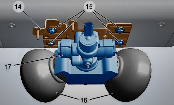

And a close up: The suspension accumulators (16)
The firmness regulator (17) with its support (14)
The same is for the Front, with the exception that there is a single accumulator.

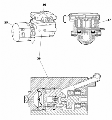

tontonjon wrote: 07 Oct 2017, 21:56 There is an accumulator sphere listed in the diagram I have been given, that "evens out the pressure pulsations of the pump". I wonder if the person who wrote it had all the facts.
There is a small 'accumulator sphere' inside the BHI for evening out the pump pulsations. Its more of a little damper & not regarded as a replaceable part, you cant see it, its inside the BHI. It's neither an accumulator or a sphere.
They may be labelled as accumulator spheres, as far as I'm concerned they are not accumulators. Surely an accumulator sphere by definition is for holding a reserve of pressure.
They hydractive 3+ manual for the mk1 makes no reference to an accumulator sphere (with the exception of the membrane pulse damper inside the BHI).
