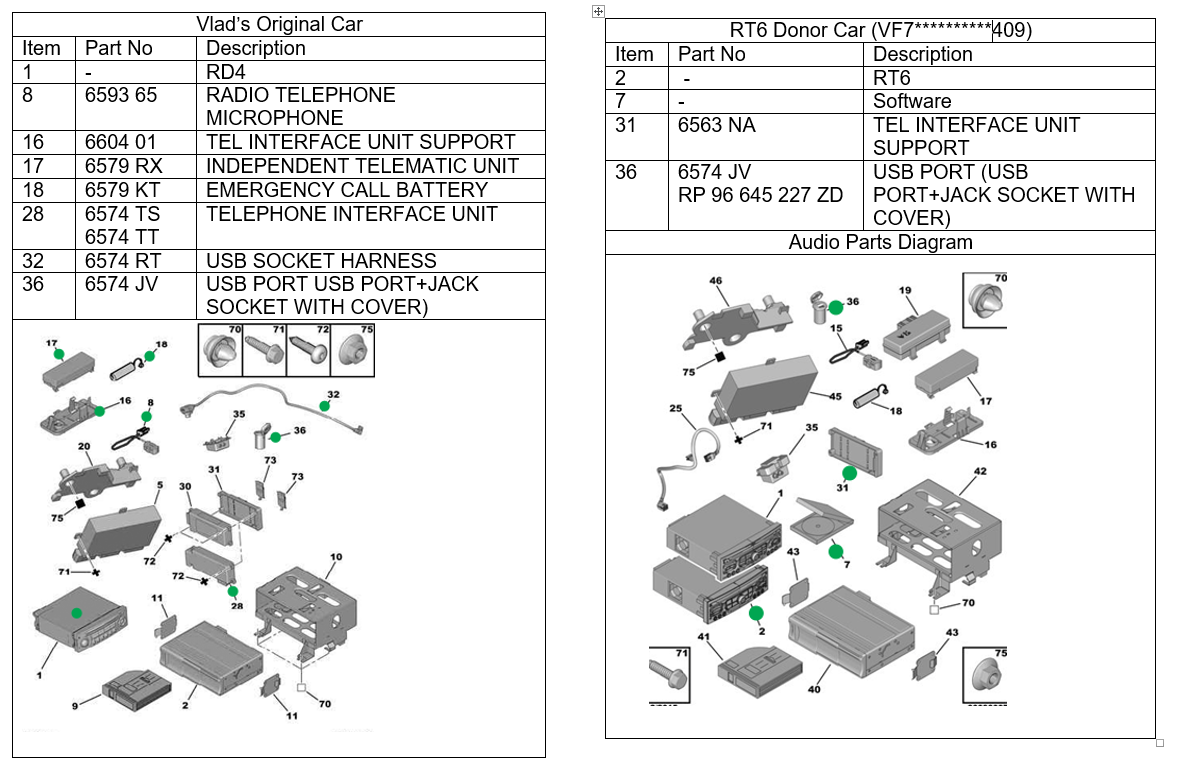

Ok, I've been looking at the RT6 donor and your system Vlad - this is a crude table for comparison:
I've marked the items that each has with green dots.
Click to zoom it up.
You can see that the USB socket is identical on both.
The only real difference is that Vlad's car has 8, 16, 17, 18, 28 & 32.
8 6593 65 RADIO TELEPHONE MICROPHONE
16 6604 01 TEL INTERFACE UNIT SUPPORT
17 6579 RX INDEPENDENT TELEMATIC UNIT
18 6579 KT EMERGENCY CALL BATTERY
28 6574 TS TELEPHONE INTERFACE UNIT OR:
6574 TT
32 6574 RT USB SOCKET HARNESS
So the difference is the Telematic Unit. Also, I found another X7 with RT6, and this model DID have the Independent telematic unit!
Another interesting thing - NON of the RT6 cars specification cars have the Radio Telephone Microphone (part 40) - that seems like it only available with the Hands Free Telephone Kit - which neither of the RT6 Car specs have - but Vlad did have this unit on his car, so he has the microphone......

This is very strange for me...Most of the modules that were used before I think now will be out of use. What I can see is that the USB Socket Harness is present on my car, so I have to find where is plugged in in the other side. So I have just to unplug it and plug it into RT6 (I think it has the same connector). Regarding the microphone, I don't think that RT6 has his own, on my car certainly not, probably it has a microphone linked somewhere. It's beyond my imagination what to do now, what to cancel, what to plug in/out...Also, part 5 on my car and 45 on the donner's one seems to be the same, but with different numbering.

vlad2004v wrote: 06 Oct 2017, 12:41 I already have this USB port & AUX in the hand rest. My question would be......Where can I found the other side (Grey Connector)?
So are you saying that the harness that you have is missing the connector at the head unit end?
I'm now wondering if this has been wired into the CD port on part C as in this link:
http://c4owners.org/print.php?plugin:faq.67
If that is the case Vlad, you would need to go back into Diagbox and enable CD Options I suspect.

On the diagrams - they show components that are available BUT NOT FITTED unless they are green - forget the rest they are not on both cars like (5 & 45). Only the parts I have listed in the table are actually fitted to both cars - this is PSA diagrams for you - they show everything on the picture side but only the parts fitted on the other side, so ignore everything that is not green.

Position 32 is green. So probably I have it and the grey connector is plugged in somewhere else. If not is exactly like you have mentioned, on fakra part C. I think I have to go back to Diagbox and activate cd changer, not player, in bsi or telematic...if this will still not work then I have to find the other side of the cable and take it from there, plugging it in rt6. This last is the most preferred by me.....
