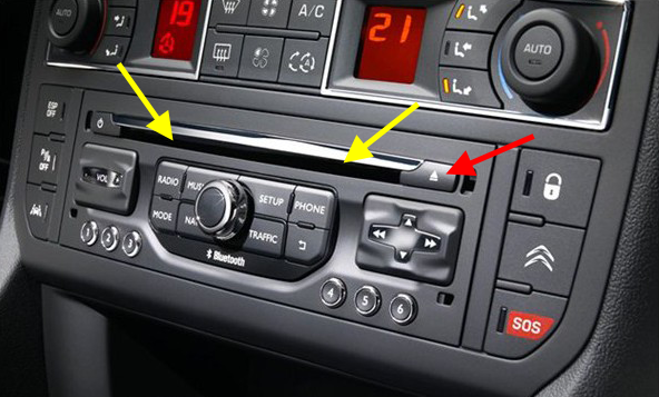

Steve, carrying on from PM...
Here is the CD Slot arrowed in Yellow and eject button in red.

Marc, either YOU are colour blind or I am! That arrow pointing at the eject button appears red to me!

Ha! Haven't used one of those for years so didn't think of using it to upgrade firmware. Doh!

James it is RED.... go back to sleep!

Ok, files are copied, CD is in head unit and upgrade has been going on for 15 mins. Shouldn't be too long to go, I'll report back with progress.
