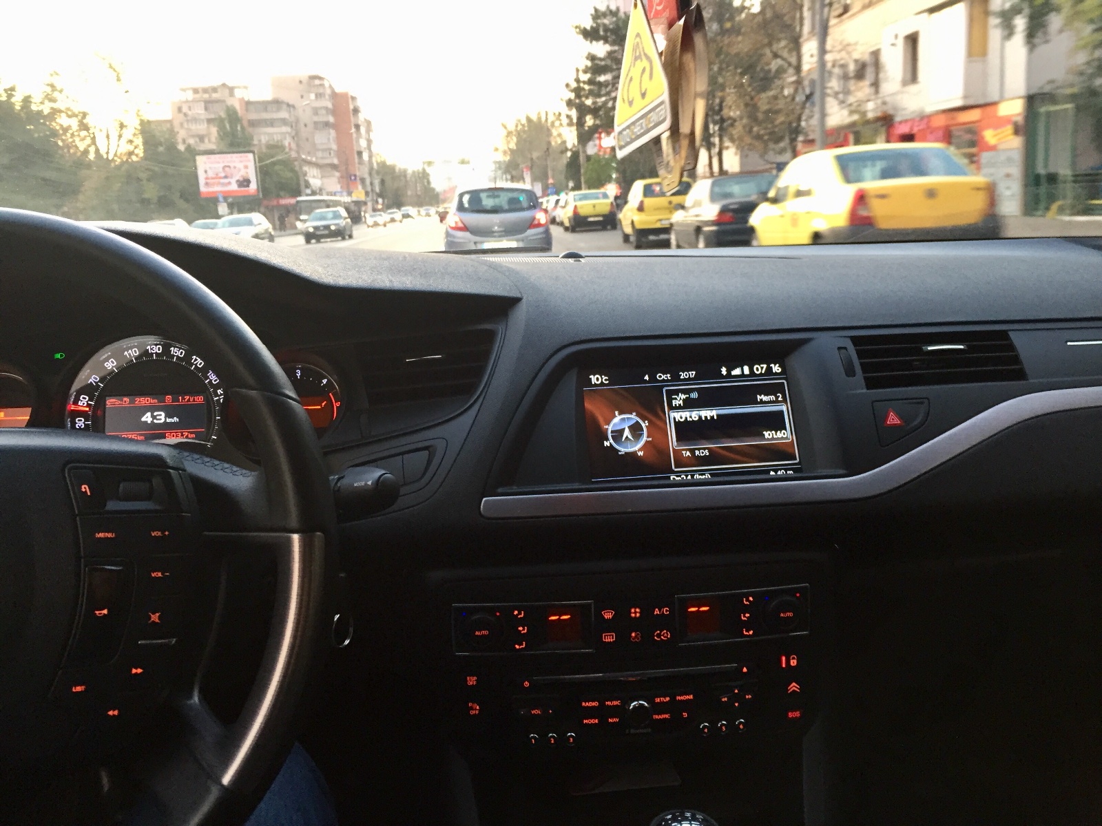

What is very very strange for me is that the fan from the RT6 is not stopping. I have locked the car and after 2 hours unlocked. And it was turned on, I was able to hear it inside. Why? Is it normal?

First good new: The fan is getting stopped after 4 minutes of locking the car. Tried by locking me inside, So this is a solved issue. Regarding the USB port, I have found from the donner the grey connector. It has 4 pins/wires.

Great news on the USB port. and Yes, I was going to say the the BSI wakes up certain vehicle ECUs when unlocked in readiness, so this might be the reason - my NG4 Navidrive 3D does similar.
