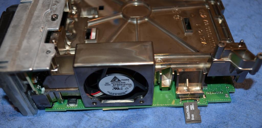

Re: C5 X7 2-in-1 navigation tutorial
I couldn’t find a thing for the mounting of the fans. Therefore I need just one info. What has to be cooled, the unit or the display? If I will find out this info, I will mount directly a cpu fan for 12V and that’s it.
- x 6962
The issues were to do with the RT6 unit not the display. The chips got a bit hot - the unit uses flash memory instead of a hard disk.
vlad2004v
- Posts: 88
- Joined: 27 Sep 2017, 13:30
- x 2
I have found an unit which is disassembled. And I see there a fan inside.
So you are sure that the cooling fans are for the unit and not for the display? I was thinking that those fans are creating an air flow for both.

- x 6962
Yes, the RT6 does have a fan, but it is already built into the unit as in your last picture. There is no separate fan part.
