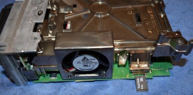

I have found an unit which is disassembled. And I see there a fan inside.
So you are sure that the cooling fans are for the unit and not for the display? I was thinking that those fans are creating an air flow for both.

I've already said - that link is for the RT3 system (RT3 Navidrive - I used to have one). That fan unit was part of the system - it does not exist in the X7.

That’s bad, so bad. Now it’s clear, a fan is needed on the rear side of the unit. The display has no heater, therefore a fan will solve nothing.

Yes, the RT6 does have a fan, but it is already built into the unit as in your last picture. There is no separate fan part.

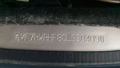

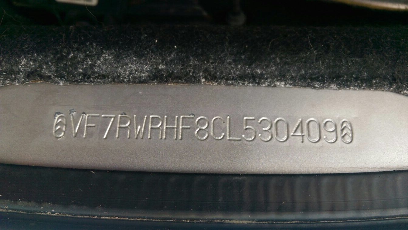

Here is the vin code from the seller. Can you please check if the wires are fine? Thank you.
- GiveMeABreak
- Posts: 37332
- Location: West Wales
C5 MK I 2.0 HDi SX Wicked Red
C15 Romahome White
XM 2.0 SX Polar White
CX 20 Polar White
GS 1220 Geranium Red
GS 1000 Cedreat Yellow - x 5721
Re: C5 X7 2-in-1 navigation tutorial
The same as before from what I can see.
